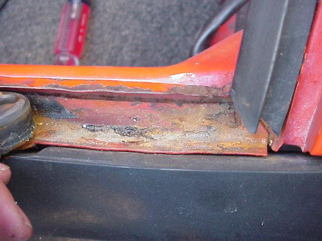

The 914/6 "rust"oration process has officially begun. I sure hope I can get out for less than $10k. Plan on some stupid CW type questions in the near future. I love pics BTW. I have some nice /4 parts to sell off to help offset the cost of this project.
Motor/tranny have been removed (many thanks to Brant, Scott, Mike and Jon for the assistance). The interior will be gutted this week. I need to remove little stuff like the fuel pump, lines, drain the tank, you get the idea. Then I get to start cutting up the parts car and stripping paint off panels to avoid spending $45/hour for body shop labor.

So, Mike, what are we seeing here with the paint? It looks like an orange re-spray over red paint or just a weird camera side effect.
(IMG:http://www.914world.com/bbs2/uploads/post-2-1050538042.jpg)
