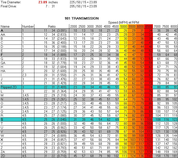

Attached ImageHere's a chart I've used for years.
The lower 2 gears of the 914 box are not so good for a six but they'll do for around the block. You decide what speed in gears *you* want and have the hp/torque to pull.
