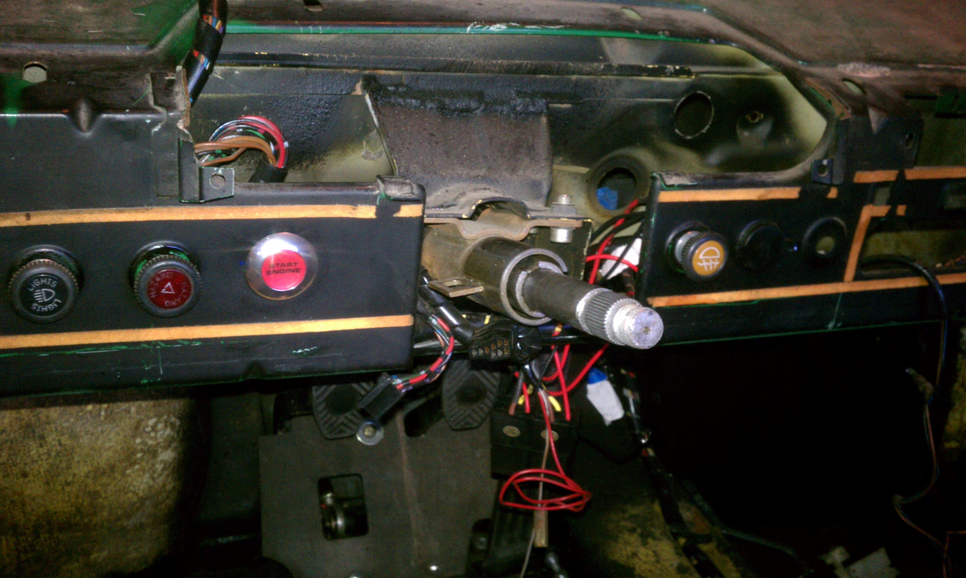

Baby steps,
I finally found a couple of hours to get the new push button ignition switch wired up. Now i need to cut off the old switch from the column and fiberglass a new cover for the column. Feels good to get rid of one more failing original piece.
