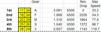

Attached ImageHere's a chart I've used for years.
The lower 2 gears of the 914 box are not so good for a six but they'll do for around the block. You decide what speed in gears *you* want and have the hp/torque to pull.

QUOTE(J P Stein @ Feb 14 2012, 07:10 AM) *
Right as usual JP, i.e., pick your poison and live with the decision.
I personally love a high reving 6, but a 4 with torque that runs at (relative) low RPM can be a great AX car.
But there are always trade offs with either decision.
If your driving a 4 the table below tells the tale. Of course I'm talking about a Porsche 4.
So a fast light 4 will require a bunch of shifting. Shorter tires (21's) will require even more. Bigger tires (16's) remove performance and handling.
