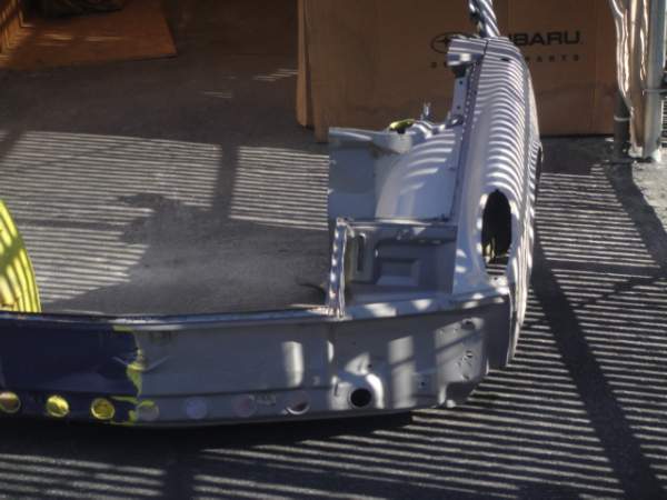

siverson   Some progress was made this week. First, the Cele...   Mar 16 2012, 02:22 PM

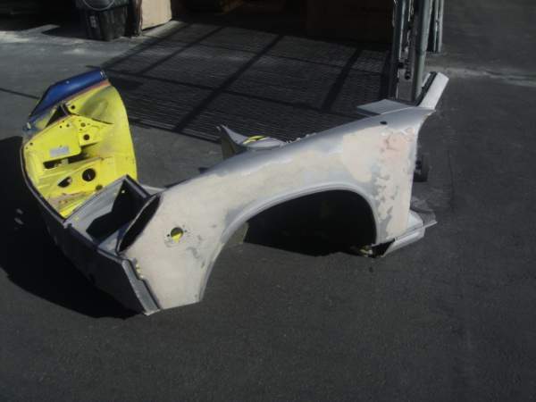

siverson   And these photos just in from European Auto Body.....   Mar 22 2012, 05:06 PM

siverson   More progress photos. And last call looking for a...   Apr 3 2012, 09:12 PM
