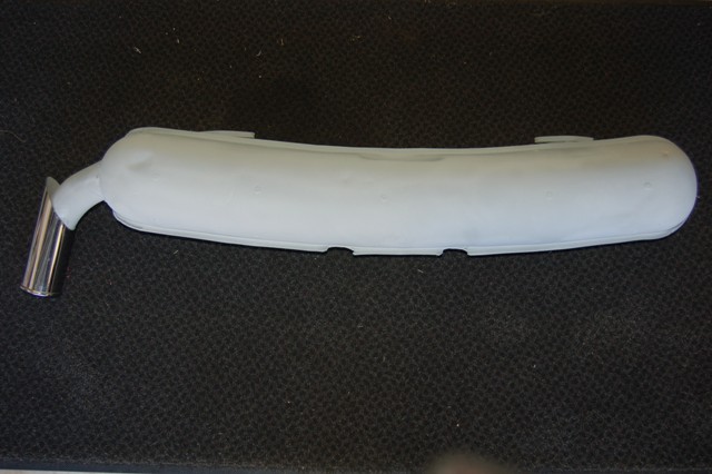

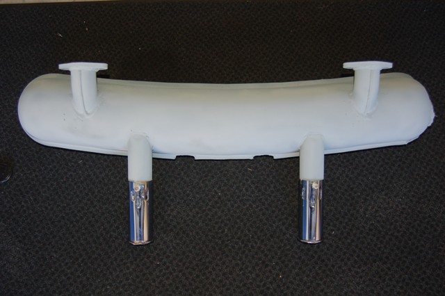

Been delayed once again with the project. I will be rubbing on this muffler set up in the weeks ahead and appreciate the comments/suggestions. I'm sure a solution will be found with all your help. Here are some pics of the two different mufflers I have to use on the car. Just not sure which one will be fitted first....I know the sound of the sport will be nice...just not sure if it will be too loud.
