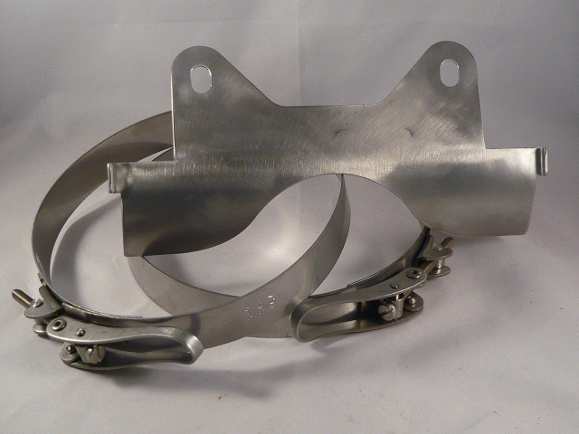

bcheney   Making progress...Here is the next issue. I mocked...   Jan 25 2012, 04:45 PM
mepstein   I would make a new hanger to fit. A flat plate of ...   Jan 25 2012, 04:54 PM
bcheney   I thought about modifying the existing hanger as w...   Jan 25 2012, 05:00 PM
Series9   I thought about modifying the existing hanger as ...   Jan 27 2012, 08:23 AM
rfuerst911sc   Bend the bracket back so it's touching the hea...   Jan 25 2012, 04:59 PM
bcheney   Bend the bracket back so it's touching the he...   Jan 25 2012, 05:04 PM
kconway   Why don't you use a GT hanger that grabs the m...   Jan 25 2012, 05:20 PM

Eric_Shea   If it's a daily driver, you may not like the s...   Feb 22 2012, 08:05 AM
JmuRiz   So, you experts think that a muffler hanger like t...   Feb 22 2012, 09:07 AM
9146986   It's better 'cause Eric sells them! ...   Feb 22 2012, 01:07 PM
