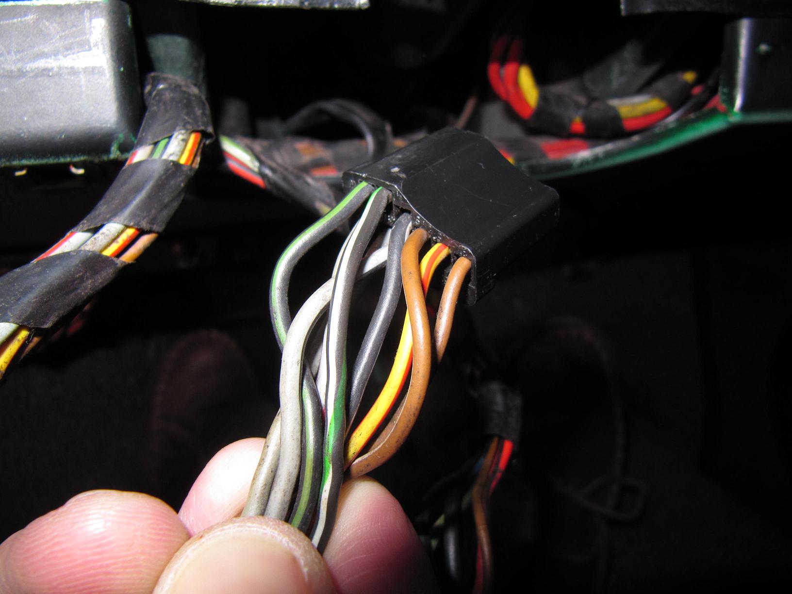

Krieger   So I am measuring between the ground terminal on t...   Feb 29 2012, 09:55 PM
Krieger   Wipers didn't move. I am going to pull out the...   Feb 29 2012, 09:27 PM
Krieger   Plug   Feb 29 2012, 10:14 PM
Valy   That's the signal switch connector. Look at th...   Feb 29 2012, 10:26 PM
Krieger   Doh! I figured that out and this is what I...   Feb 29 2012, 10:34 PM
Valy   OK. Green/white shows that your wipers are probabl...   Feb 29 2012, 10:44 PM
Krieger   black/purple 10.7 black/blue 10.2   Feb 29 2012, 10:53 PM
