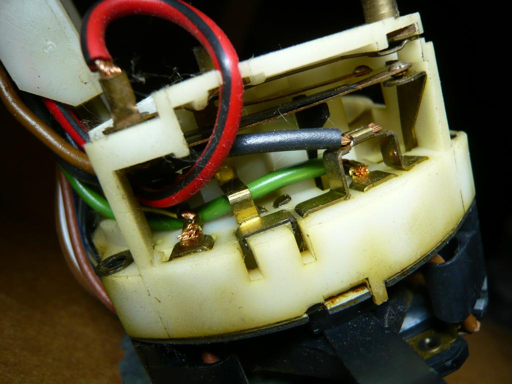

I am trying to figure out what I have here. I noticed that there are two different wiper switches available. 70-72 and 73-76.
This is the one that is in the best condition.
Notice that it only has four pins on the left side.
I have already attached a switch that I got from davep, which will trigger my electric washer pump that I plan to install.
This is the second one that I have. Being in worse condition out of the two.
It has five pins on the left side. The extra one being a brown, which is ground correct?
The switch is also different in that the plunger that would activate the washer fluid has an electrical contact
I am running a wiring harness from a 72 car. Which switch do I need to use? Am i missing pieces from the first switch maybe?
Im stumped here...

Your backdate column is grounded. Check from something protruding from the switch that touches the column when installed.
Also check that the small detachable copper tab is installed correctly.
Again, a picture would help a lot.

Krieger   Hey, I'm at it again. Here are some observat...   Mar 1 2012, 09:16 PM
Valy   Your backdate column is grounded. Check from somet...   Mar 1 2012, 09:37 PM
Krieger   There was a small "protrusion" I filed ...   Mar 1 2012, 10:01 PM
Krieger   The protrusion was similar to the top right of you...   Mar 1 2012, 10:07 PM
Valy   :trophy: Happy to help :)   Mar 1 2012, 11:15 PM
