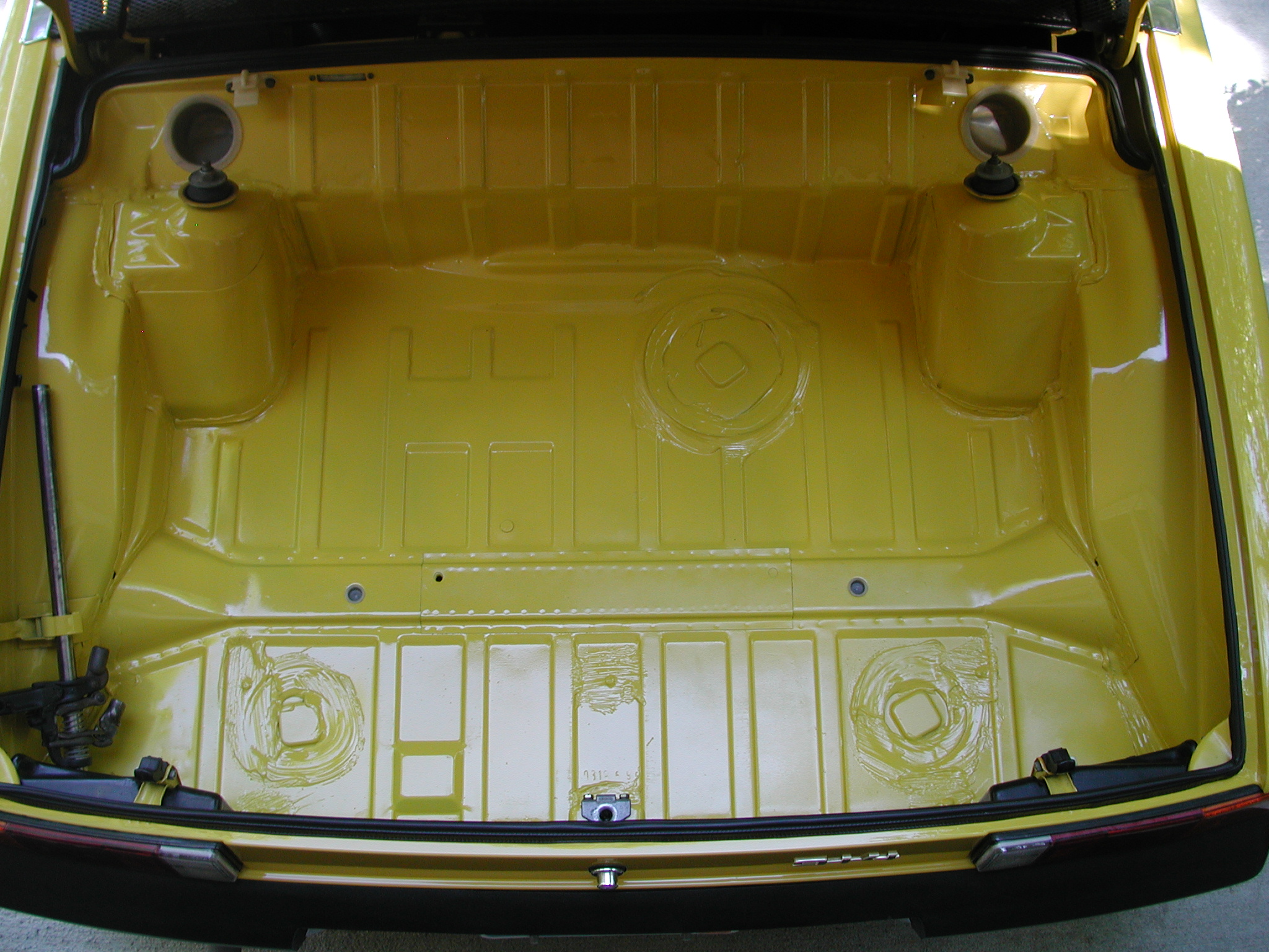

1970 Neun vierzehn   since we are at the rear, let's look in the tr...   Mar 4 2012, 12:50 PM
Jeff Bowlsby   since we are at the rear, let's look in the t...   Mar 4 2012, 06:19 PM
1970 Neun vierzehn   since we are at the rear, let's look in the ...   Mar 4 2012, 08:21 PM
Gustl   the rubber caps at the domes are missing ...   Mar 4 2012, 12:52 PM
1970 Neun vierzehn   the rubber caps at the domes are missing ... Th...   Mar 4 2012, 01:00 PM
6freak   the rubber caps at the domes are missing ... T...   Mar 4 2012, 01:11 PM
sixerdon   the rubber caps at the domes are missing ... T...   Mar 4 2012, 04:26 PM

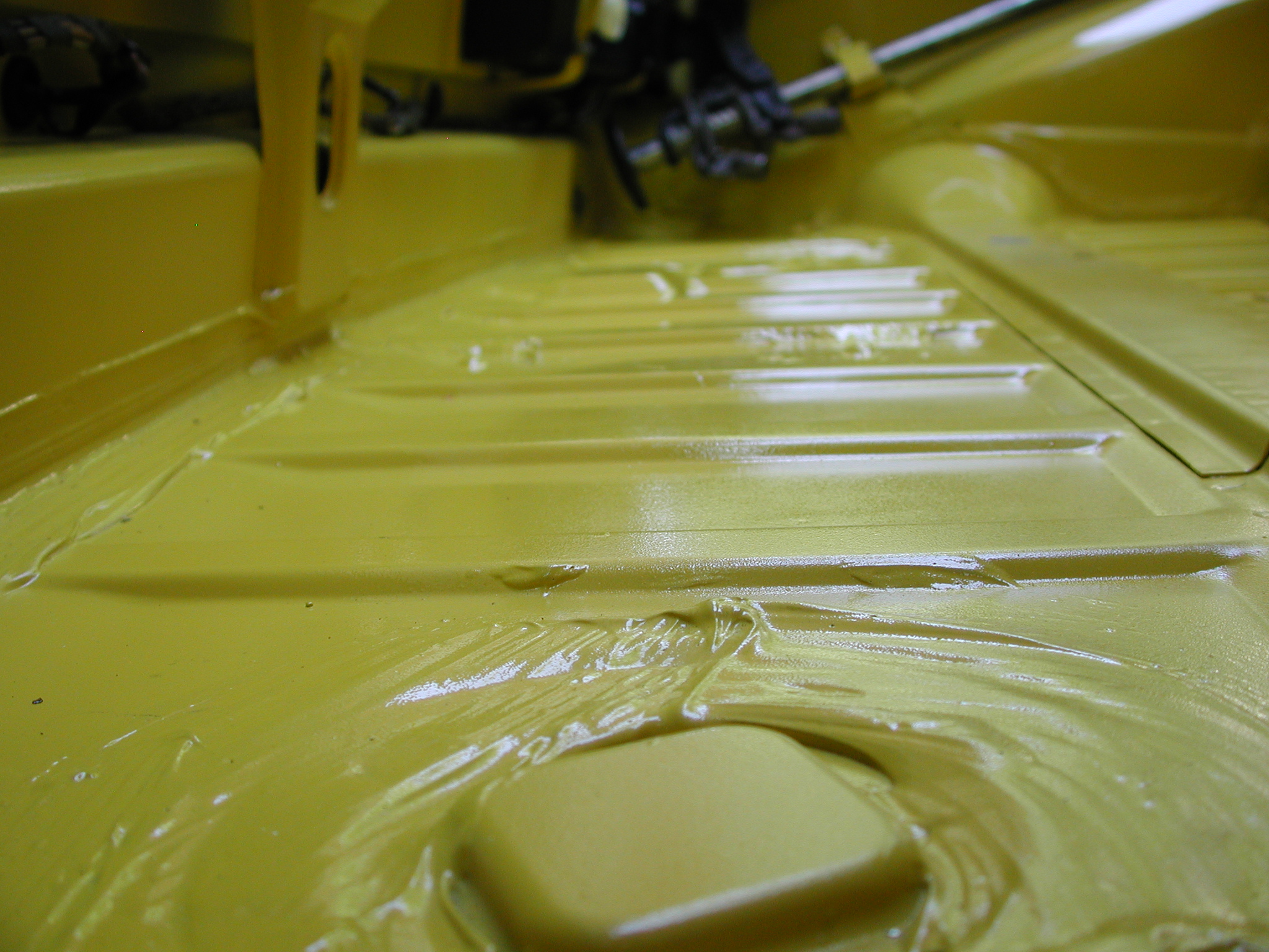

1970 Neun vierzehn   without the carpet (w/ stain that I can't get ...   Mar 4 2012, 12:55 PM
SirAndy   without the carpet (w/ stain that I can't get...   Mar 4 2012, 04:16 PM
1970 Neun vierzehn   [quote name='1970 Neun vierzehn' post='1638942' d...   Mar 4 2012, 07:39 PM
Pat Garvey   [quote name='1970 Neun vierzehn' post='1638942' ...   Mar 5 2012, 05:52 PM
SirAndy   [quote name='1970 Neun vierzehn' post='1638942' d...   Mar 5 2012, 09:45 PM
1970 Neun vierzehn   last rear trunk pics......   Mar 4 2012, 01:09 PM
unpolire   Is this an unrestored car? Rust free and original...   Mar 4 2012, 01:18 PM
1970 Neun vierzehn   Is this an unrestored car? Rust free and origina...   Mar 4 2012, 01:32 PM
1970 Neun vierzehn   ...but underneath the paint and floor.....   Mar 4 2012, 01:37 PM
1970 Neun vierzehn   as there wasn't really all that much in the re...   Mar 4 2012, 01:51 PM

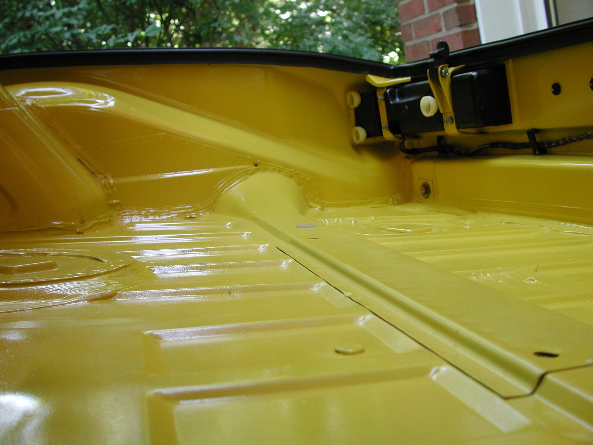

1970 Neun vierzehn   sides....   Mar 4 2012, 01:54 PM
Jeff Bowlsby   sides.... The white plastic edge protection is ...   Mar 4 2012, 06:24 PM
1970 Neun vierzehn   sides.... The white plastic edge protection is...   Mar 4 2012, 08:22 PM
1970 Neun vierzehn   ID #s in trunk   Mar 4 2012, 01:56 PM
6freak   interesting place for the tow loop   Mar 4 2012, 02:14 PM
1970 Neun vierzehn   interesting place for the tow loop always thoug...   Mar 4 2012, 02:21 PM
6freak   interesting place for the tow loop always thou...   Mar 4 2012, 03:48 PM
1970 Neun vierzehn   Interesting, I didn't know that the suspensi...   Mar 4 2012, 07:28 PM
Gustl   now it's definitely clear that the Pedrinis we...   Mar 4 2012, 04:16 PM
1970 Neun vierzehn   now it's definitely clear that the Pedrinis w...   Mar 4 2012, 08:36 PM
Gustl   it the VIN tag (the bigger one) original or repro?...   Mar 4 2012, 04:19 PM
1970 Neun vierzehn   it the VIN tag (the bigger one) original or repro...   Mar 4 2012, 07:43 PM
sixerdon   Confirming Paul's comments...... Rear trunk c...   Mar 5 2012, 05:12 PM
Pat Garvey   Good on ya Paul! We should do more of these ...   Mar 5 2012, 05:56 PM
