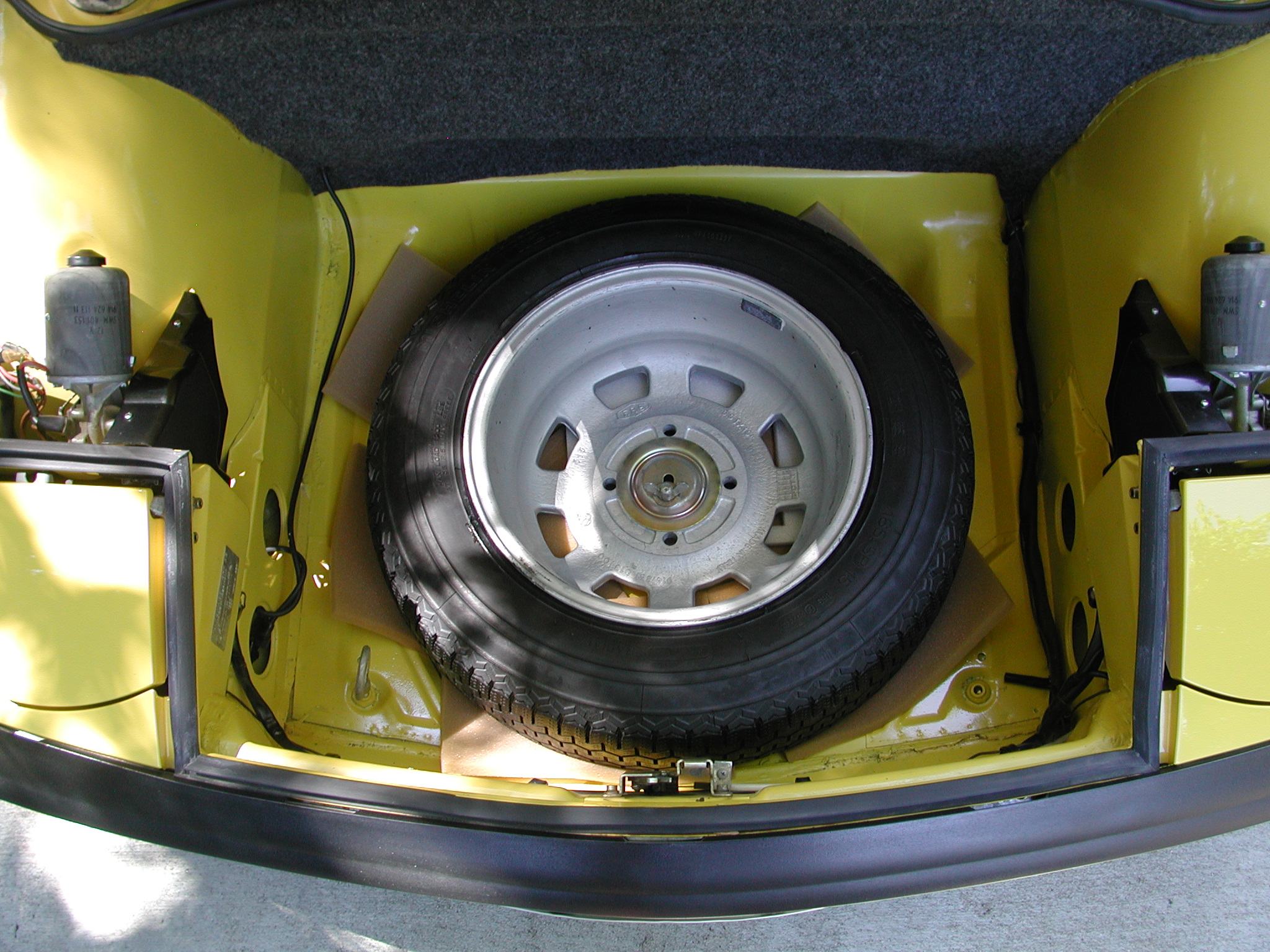

as there wasn't really all that much in the rear trunk with the only concern dealing with the rubber caps that were never there to begin with, let's go to the other end of the car and look inside the front lid.
please disregard the foam pieces under the spare......they are there to keep the rubber from marring and staining the paint.

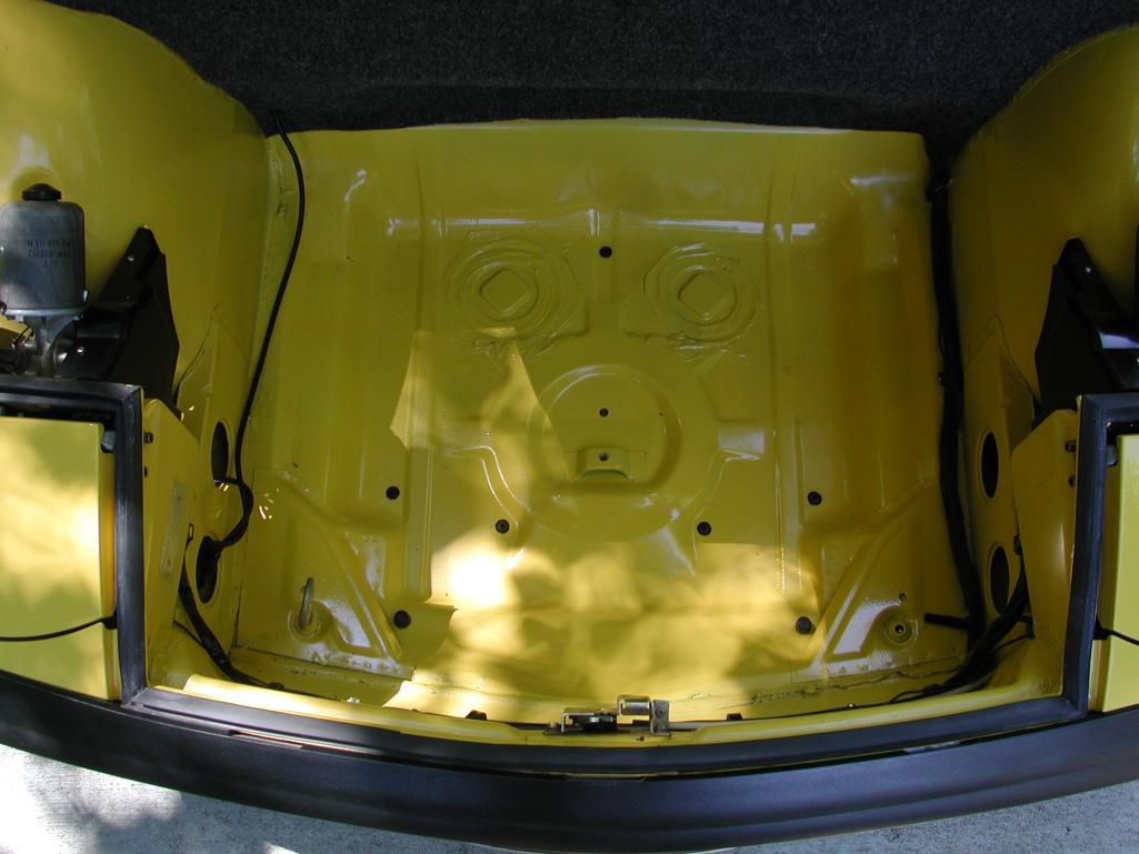

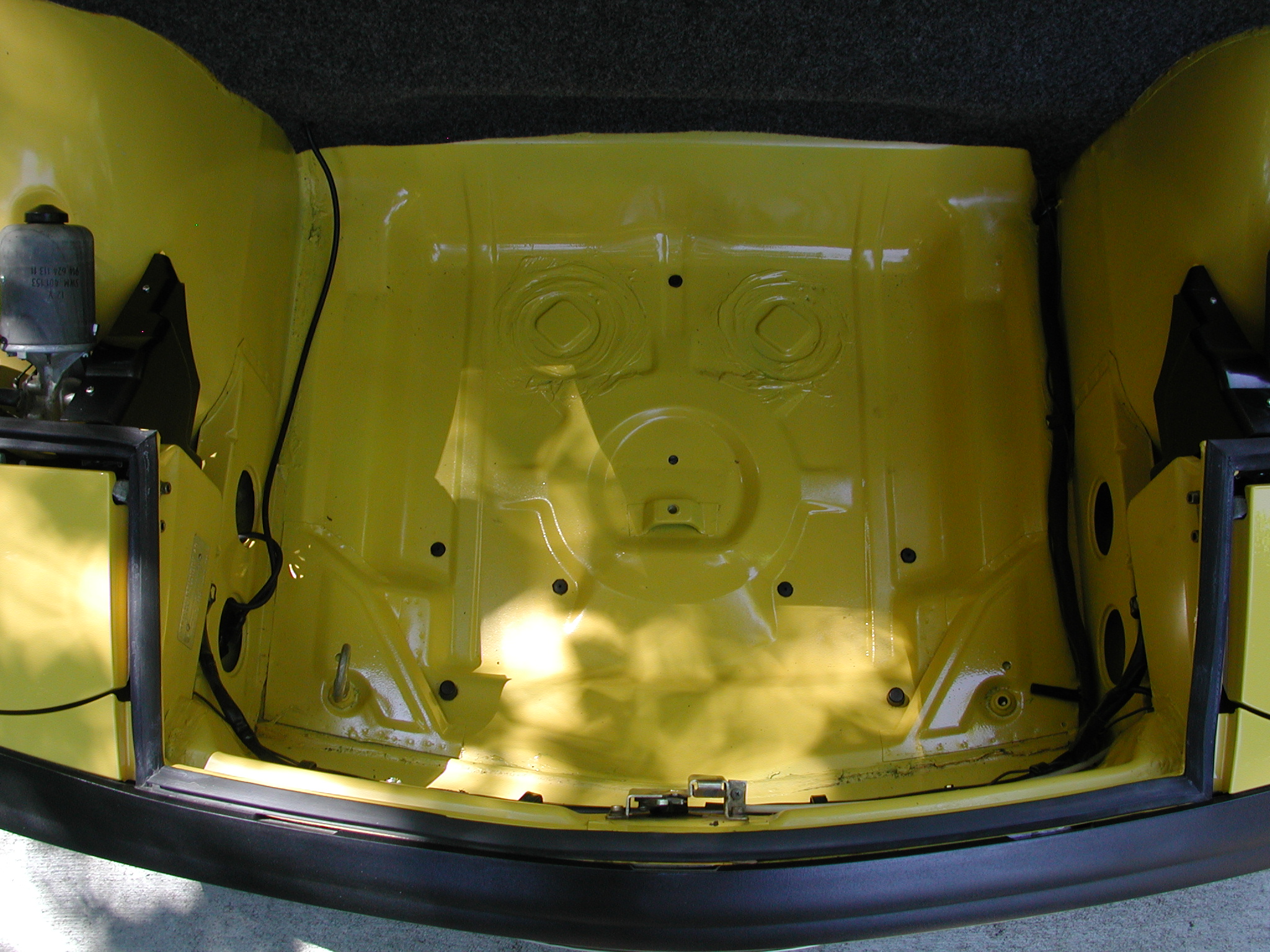

1970 Neun vierzehn   since we are at the rear, let's look in the tr...   Mar 4 2012, 12:50 PM
Jeff Bowlsby   since we are at the rear, let's look in the t...   Mar 4 2012, 06:19 PM
1970 Neun vierzehn   since we are at the rear, let's look in the ...   Mar 4 2012, 08:21 PM
Gustl   the rubber caps at the domes are missing ...   Mar 4 2012, 12:52 PM
1970 Neun vierzehn   the rubber caps at the domes are missing ... Th...   Mar 4 2012, 01:00 PM
6freak   the rubber caps at the domes are missing ... T...   Mar 4 2012, 01:11 PM
sixerdon   the rubber caps at the domes are missing ... T...   Mar 4 2012, 04:26 PM

1970 Neun vierzehn   last rear trunk pics......   Mar 4 2012, 01:09 PM
unpolire   Is this an unrestored car? Rust free and original...   Mar 4 2012, 01:18 PM
1970 Neun vierzehn   Is this an unrestored car? Rust free and origina...   Mar 4 2012, 01:32 PM
1970 Neun vierzehn   ...but underneath the paint and floor.....   Mar 4 2012, 01:37 PM
1970 Neun vierzehn   as there wasn't really all that much in the re...   Mar 4 2012, 01:51 PM
