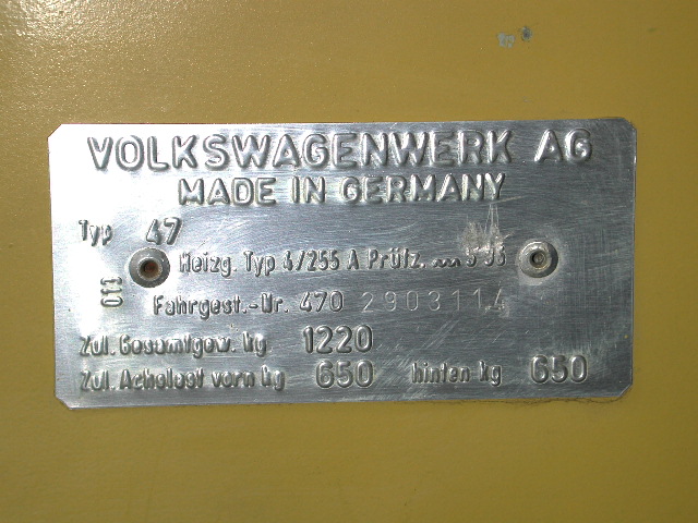

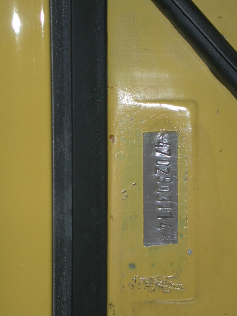

1970 Neun vierzehn   ID #s in trunk   Mar 4 2012, 01:56 PM

Gustl   it the VIN tag (the bigger one) original or repro?...   Mar 4 2012, 04:19 PM
1970 Neun vierzehn   it the VIN tag (the bigger one) original or repro...   Mar 4 2012, 07:43 PM
