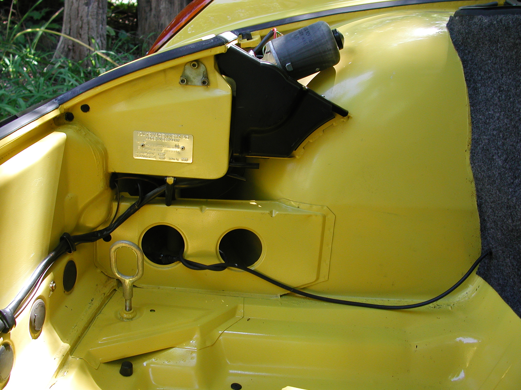

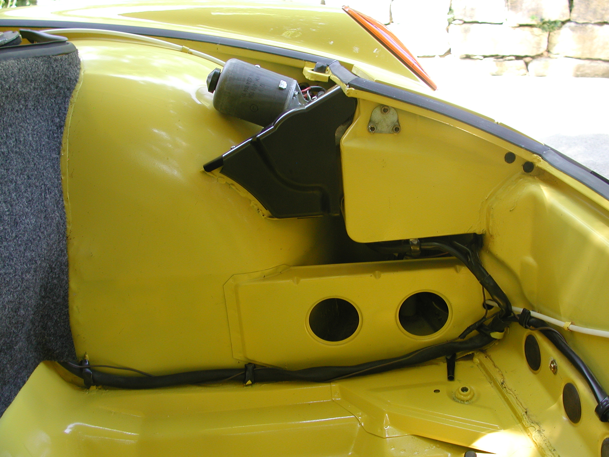

1970 Neun vierzehn   last rear trunk pics......   Mar 4 2012, 01:09 PM
unpolire   Is this an unrestored car? Rust free and original...   Mar 4 2012, 01:18 PM
1970 Neun vierzehn   Is this an unrestored car? Rust free and origina...   Mar 4 2012, 01:32 PM
1970 Neun vierzehn   ...but underneath the paint and floor.....   Mar 4 2012, 01:37 PM
1970 Neun vierzehn   as there wasn't really all that much in the re...   Mar 4 2012, 01:51 PM

Jeff Bowlsby   sides.... The white plastic edge protection is ...   Mar 4 2012, 06:24 PM
1970 Neun vierzehn   sides.... The white plastic edge protection is...   Mar 4 2012, 08:22 PM

sixerdon   Confirming Paul's comments...... Rear trunk c...   Mar 5 2012, 05:12 PM
Pat Garvey   Good on ya Paul! We should do more of these ...   Mar 5 2012, 05:56 PM
