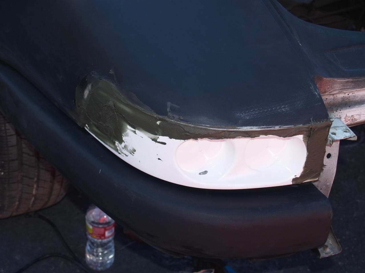

Nothin' like progress.
Getting the front and rear R light buckets installed. They are going to be smoothed into the front and rear fenders.
Here is the front
And the rear

QUOTE(hwgunner @ Mar 2 2012, 01:00 PM) *
... Here is the front ...
Can you see if the M-Y is stamped somewhere inside the bucket?

QUOTE(euro911 @ Mar 2 2012, 06:04 PM) *
I looked with my good glasses and a flashlight and did not see anything in the buckets. Sorry.
