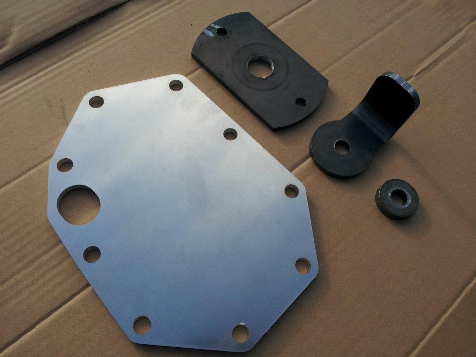

Just an update, Things are finally coming together. (IMG:style_emoticons/default/piratenanner.gif) Should have products to sell before the end of the month...
here's a teaser shot of some of the laser cutting being used in the in the project (IMG:style_emoticons/default/biggrin.gif)
