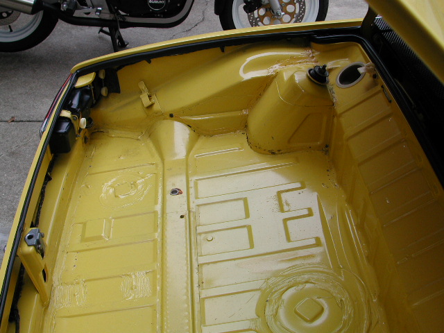

without the carpet (w/ stain that I can't get out)

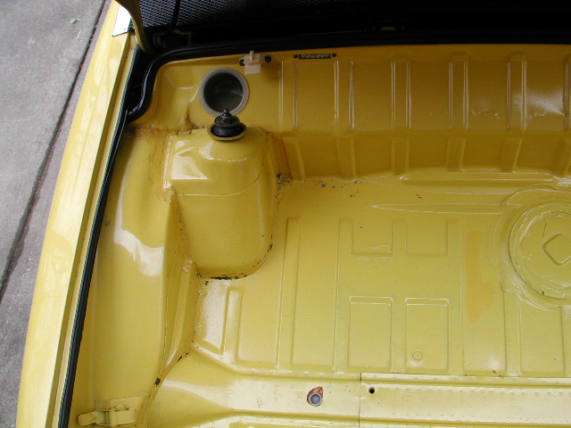

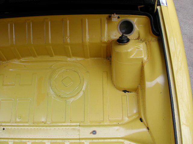

Resident German ![]() ![]() ![]() ![]() ![]() ![]() ![]() ![]() ![]() ![]() ![]() ![]() ![]() ![]() ![]() ![]() ![]() ![]() ![]() ![]() ![]() ![]() ![]() ![]() ![]() Group: Admin Posts: 42,483 Joined: 21-January 03 From: Oakland, Kalifornia Member No.: 179 Region Association: Northern California |
without the carpet (w/ stain that I can't get out) The seam sealer around the rear shock towers does not look original. It should have been sprayed on, not brushed. (IMG:style_emoticons/default/shades.gif) |

without the carpet (w/ stain that I can't get out) The seam sealer around the rear shock towers does not look original. It should have been sprayed on, not brushed. (IMG:style_emoticons/default/shades.gif) Sir Andy, I understand that the early production cars had the seam sealer applied by hand with a brush, rather than the typically seen, later style sprayed app. The accompanying pic shows the rear trunk before restoration. Paul Attached image(s)

without the carpet (w/ stain that I can't get out) The seam sealer around the rear shock towers does not look original. It should have been sprayed on, not brushed. (IMG:style_emoticons/default/shades.gif) Sir Andy, I understand that the early production cars had the seam sealer applied by hand with a brush, rather than the typically seen, later style sprayed app. The accompanying pic shows the rear trunk before restoration. Paul Agree with this! Brush was used on early cars. Not certain when the change was made, but my late 72 definitely was sprayed. |
