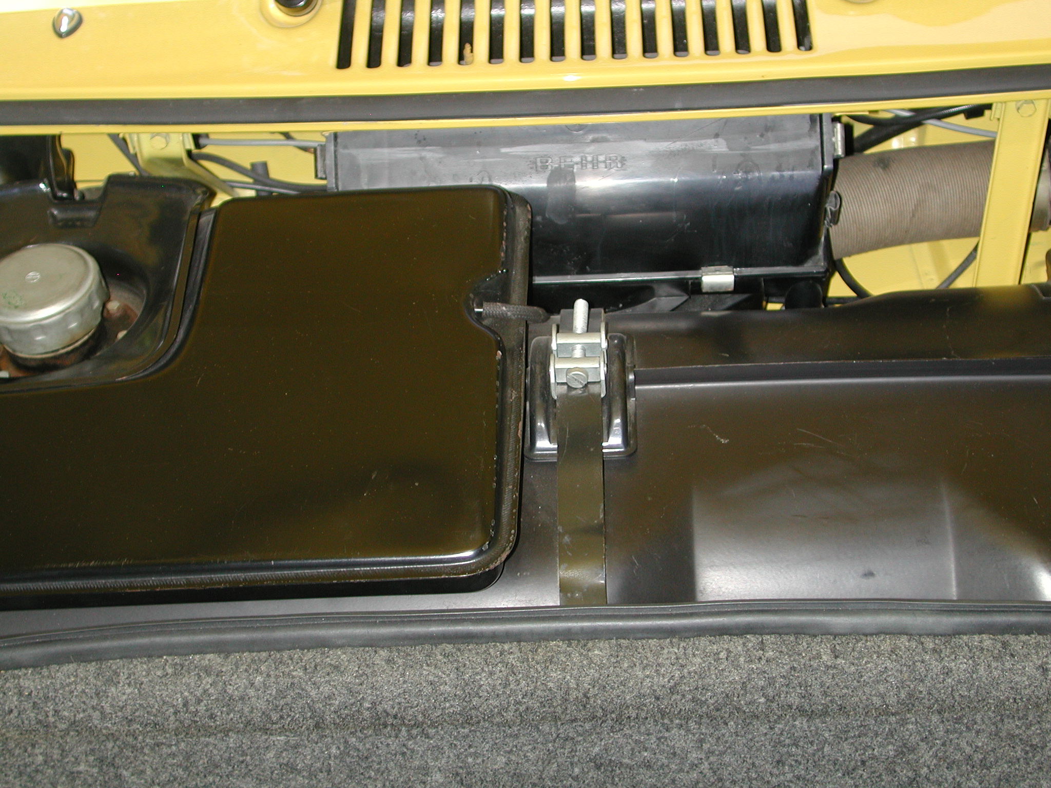

1970 Neun vierzehn   Before we go inside to the passenger compartment a...   Mar 5 2012, 06:38 PM
1970 Neun vierzehn   detail, outside.......   Mar 5 2012, 06:40 PM
sixerdon   detail, outside....... Confirmed there was no ...   Mar 5 2012, 09:16 PM
1970 Neun vierzehn   w/s washer bottle side.....   Mar 5 2012, 06:41 PM
1970 Neun vierzehn   along the centerline......   Mar 5 2012, 06:42 PM
1970 Neun vierzehn   brake reservoir side....   Mar 5 2012, 06:44 PM
tod914   Paul, I don't know enough about the 70 model y...   Mar 6 2012, 01:18 PM
1970 Neun vierzehn   Don, You noticed the lack of a screen :clap: , y...   Mar 6 2012, 07:34 PM
1970 Neun vierzehn   AARGH :angry: I just now noticed...................   Mar 6 2012, 07:39 PM
SirAndy   I did have a sticker on the w/s washer bottle. Lo...   Mar 6 2012, 09:45 PM
