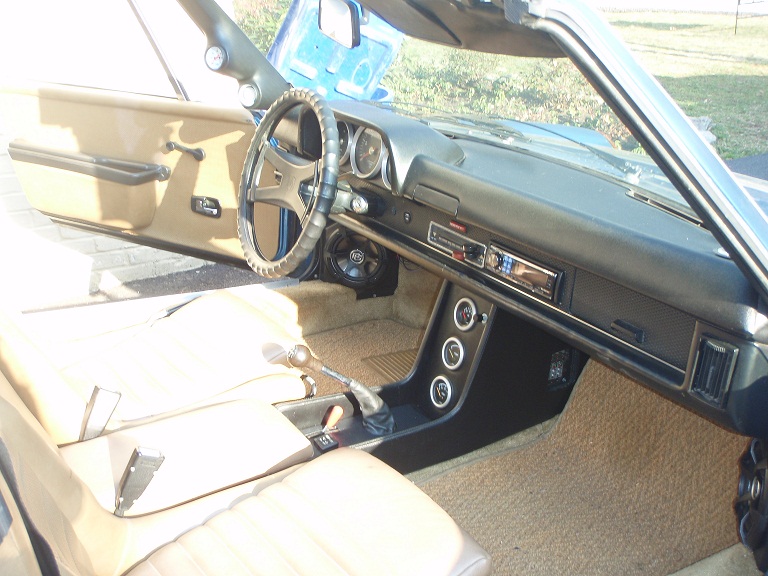

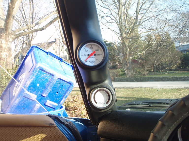

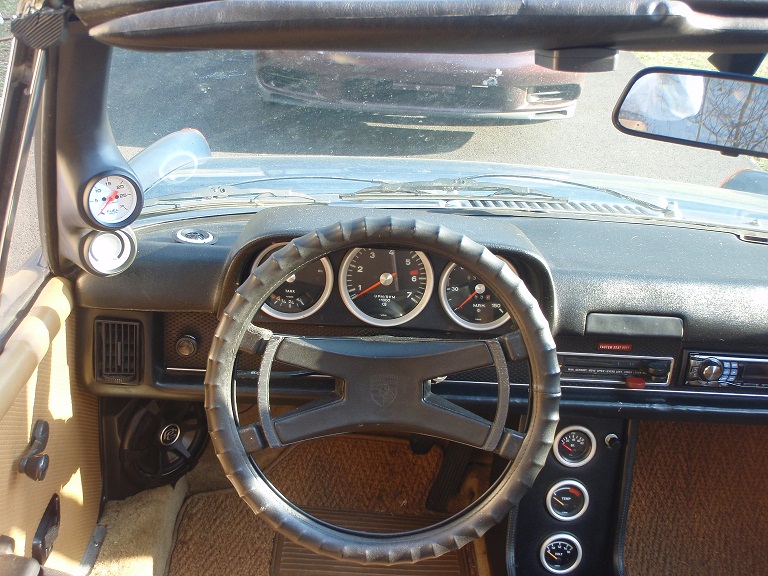

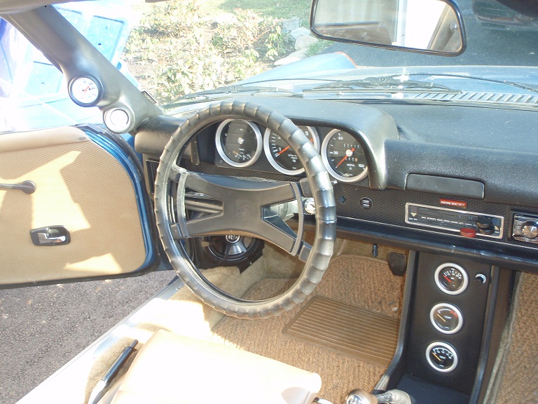

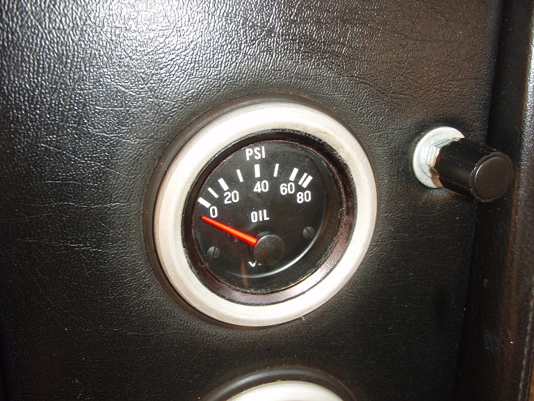

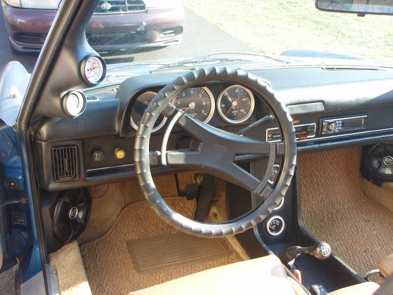

Waiting to move foreward on my engine.... I figured I needed to work on somthing.
I went ahead and added some gauges to the teener today. (3) to be exact. I got rid of the clock and replaced it with an oil pressure gauge. It is smaller than the stock gauge, so I used a bit of superglue and managed to get my aluminum ring to fit pretty well. I didnt want to loose the uniform look with the trim rings I purchased.
The other 2 went on the pillar, a fuel pressure gauge to monitor the D-Jet, and a Air Fuel gauge to keep in tune. (IMG:style_emoticons/default/biggrin.gif) I did not want to install the pillar at first, but bit the bullet when i saw the alternatives. I actually really like it
(IMG:style_emoticons/default/cheer.gif)
