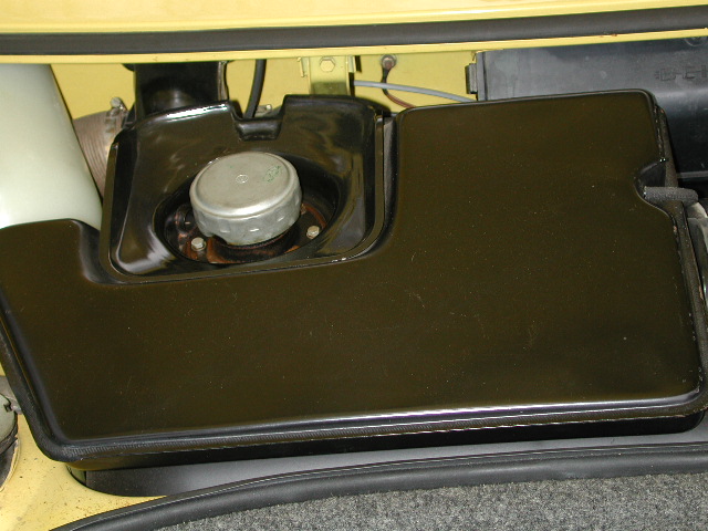

Don,
You noticed the lack of a screen (IMG:style_emoticons/default/clap56.gif) , yet another "missing" item on early cars. And there is another "omission" further on in this thread, as we shall see (or not see as the case may be).
The nuts for the wiper arms are natural metal (I'm supposing aluminum).

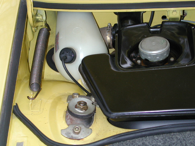

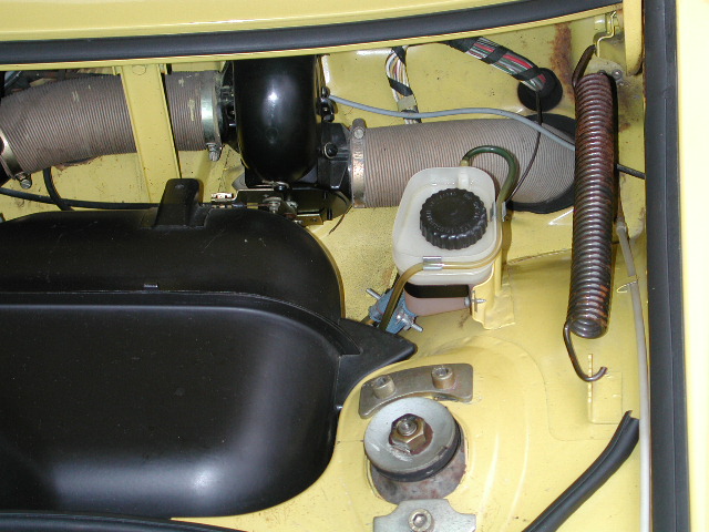

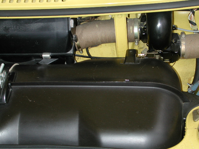

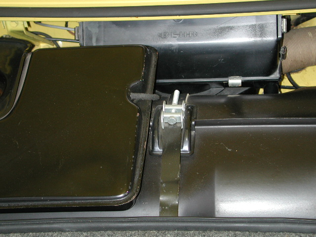

Todd,
No labels ever in the cowl, not even on the w/s washer bottle.
The fuel tank strap has always been silver.
There has never been a charcoal canister on this car (an early 49 state example)
Yes, I understand later 914s had a slightly different brake fluid reservoir.
