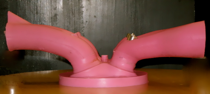

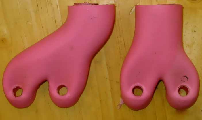

I have always appreciated the abilities of the Suby engine no matter what it is installed into.. Honestly if the cost of TIVs wasn't so high, cores so old and the quality of parts not going to last another 30 years I would have never diversified into the Suby.
After we developed the Type 4 as well as possible for any sane HP level and expense it was time for a change- because the following has changed and continues to. I know that the TIV will be completely dead before I close the door to my office for the final time so diversification into the M96/ M97 years ago and now the Suby was simply required.
As aircooled engine component quality continues to deteriorate its important that we lead the way with the next level of Suby engine development with a different scope of basic alterations not found with the typical "Suby Tuners". Merging classic hotrodding with a modern engine and a twist is what its all about and thats more than the "tuners" do. One good example of this is the creation of an engine that doesn't "sound" like a Suby. I hate the signature sound of a suby and so do most other air-cooled enthusiast and making the Suby sound like a well tuned -4 has been a fairly large undertaking as the differences go well beyond the exhaust system. Here is an example.
And this is the other key.. WOW what bazaar things I found when playing with these numbers!
(IMG:http://www.914world.com/bbs2/uploads_offsite/fbcdn-sphotos-a.akamaihd.net-1095-1331170288.1.jpg)
I do not have any plans to provide Suby>>>>>914 components. My internal engine developments can be universally applied but I have decided not to focus any of my efforts on the 914 specifically.
Now those who want a Raby engine have their choice of classic air-cooled, or modern water-cooled and I am having more fun than ever making it happen.
