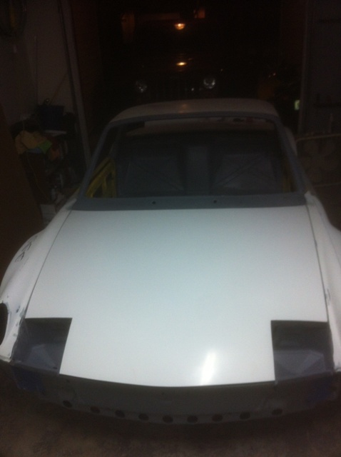

effutuo101   Refitting intakes yesterday. Just a couple of mino...   Mar 13 2012, 10:15 AM
jcambo7   Refitting intakes yesterday. Just a couple of min...   Mar 13 2012, 10:37 AM
effutuo101   Rear deck fitted, naca ducts finalizes, roof 99.9%...   Mar 14 2012, 09:20 PM
