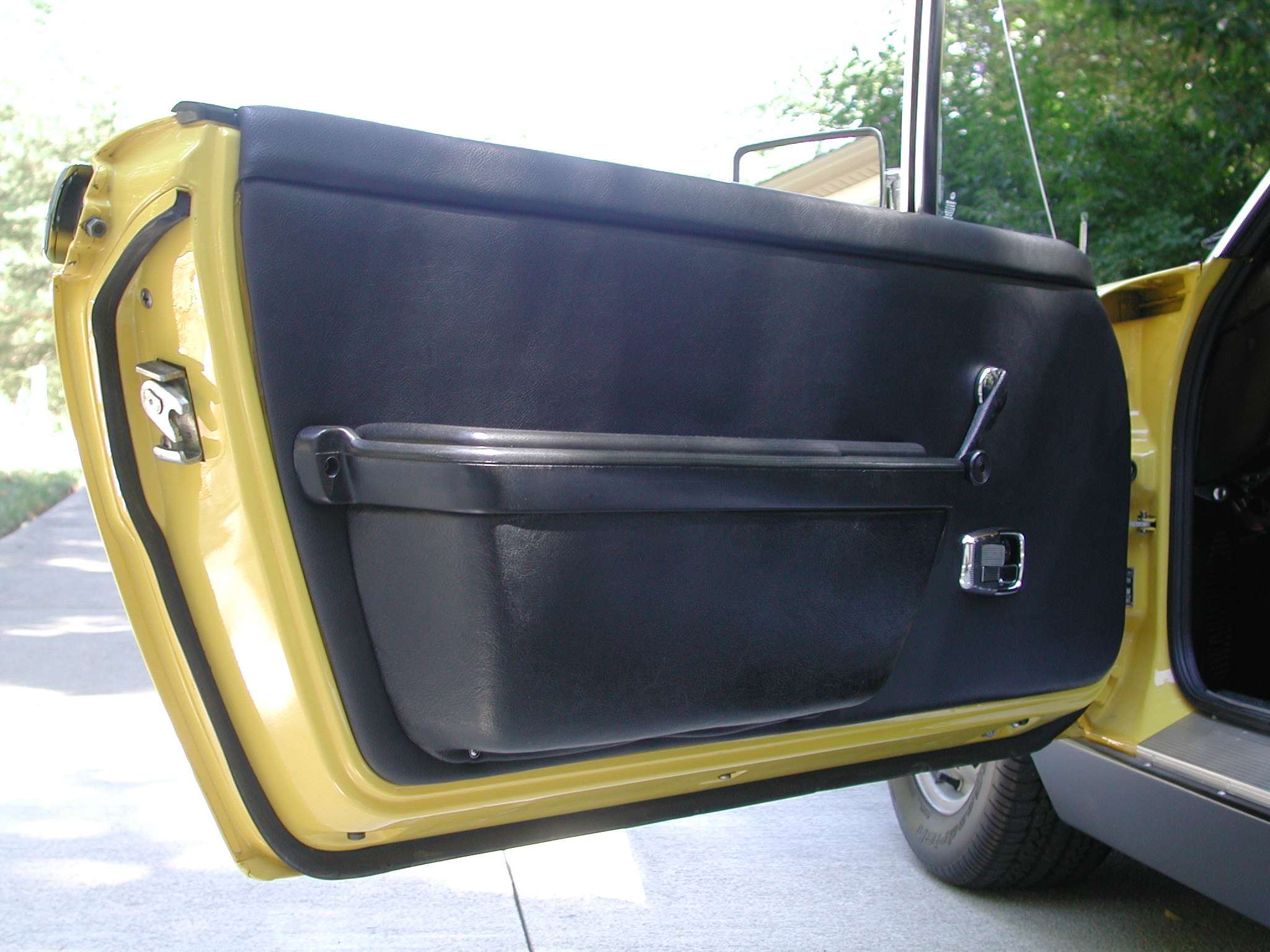

looking inside.......
Attached thumbnail(s) |
