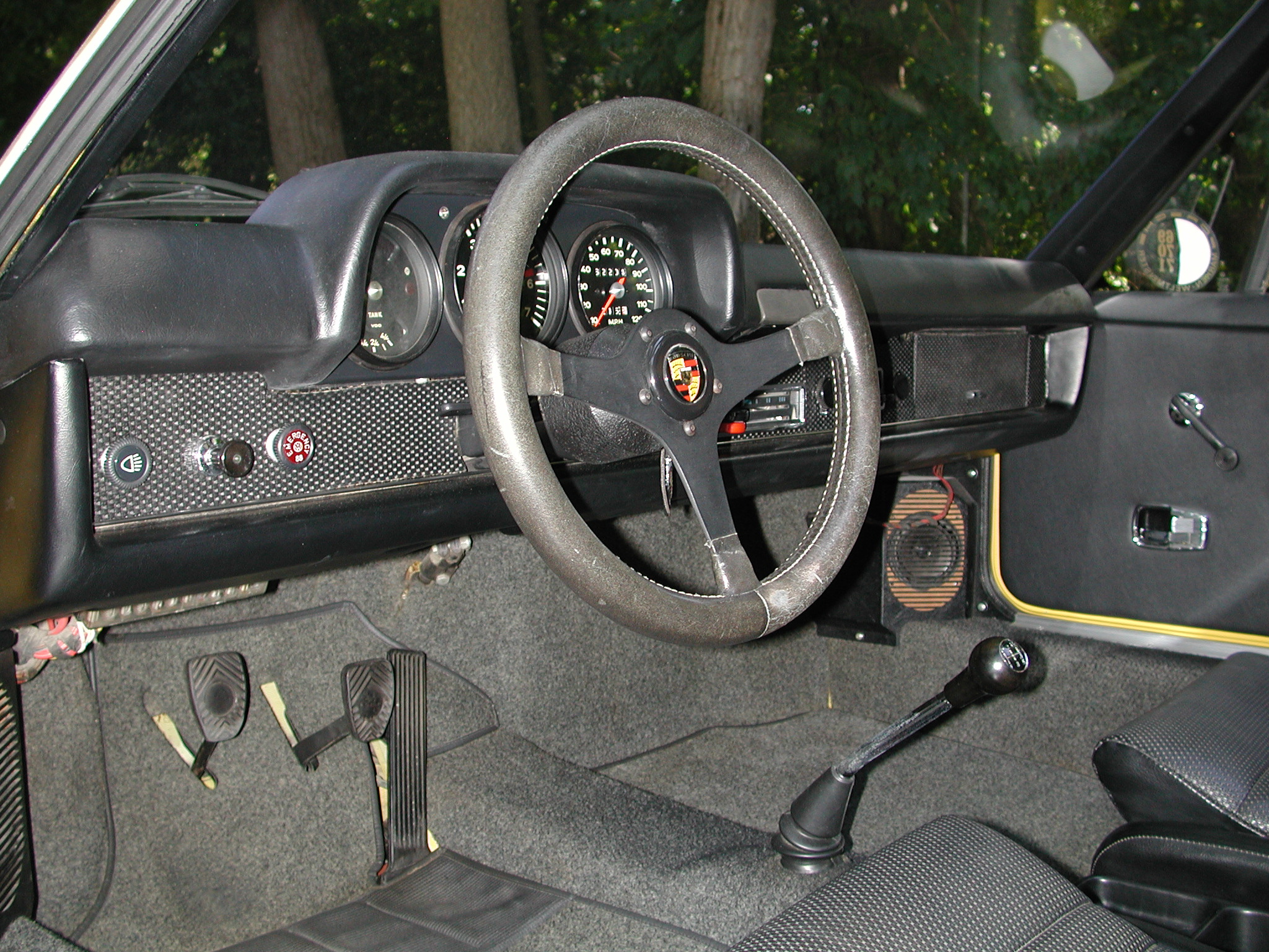

1970 Neun vierzehn Before we go inside the passenger compartment, a q... Mar 7 2012, 09:07 PM
1970 Neun vierzehn looking inside....... Mar 9 2012, 09:39 PM
Jasfsmith
Missing the plug that cov... Mar 15 2012, 11:29 AM
1970 Neun vierzehn
Missing the plug that co... Mar 15 2012, 08:03 PM
1970 Neun vierzehn from another angle...... Mar 9 2012, 09:43 PM
1970 Neun vierzehn dashboard fascia Mar 9 2012, 09:45 PM
1970 Neun vierzehn and.... Mar 9 2012, 09:46 PM
1970 Neun vierzehn seats Mar 9 2012, 09:47 PM
Jasfsmith
seats
Seat belt safety manufacture labels missi... Mar 15 2012, 11:33 AM
1970 Neun vierzehn
seats
Seat belt safety manufacture labels miss... Mar 15 2012, 08:14 PM
1970 Neun vierzehn center tray..... Mar 9 2012, 09:48 PM
1970 Neun vierzehn interior light Mar 9 2012, 09:50 PM
1970 Neun vierzehn recepticle for the drivers' side (only) seatbe... Mar 9 2012, 09:51 PM
1970 Neun vierzehn early top, w/o headliner Mar 9 2012, 09:54 PM
Gustl obviously the steering wheel is not factory origin... Mar 9 2012, 11:40 PM
1970 Neun vierzehn
obviously the steering wheel is not factory origi... Mar 10 2012, 12:09 AM
