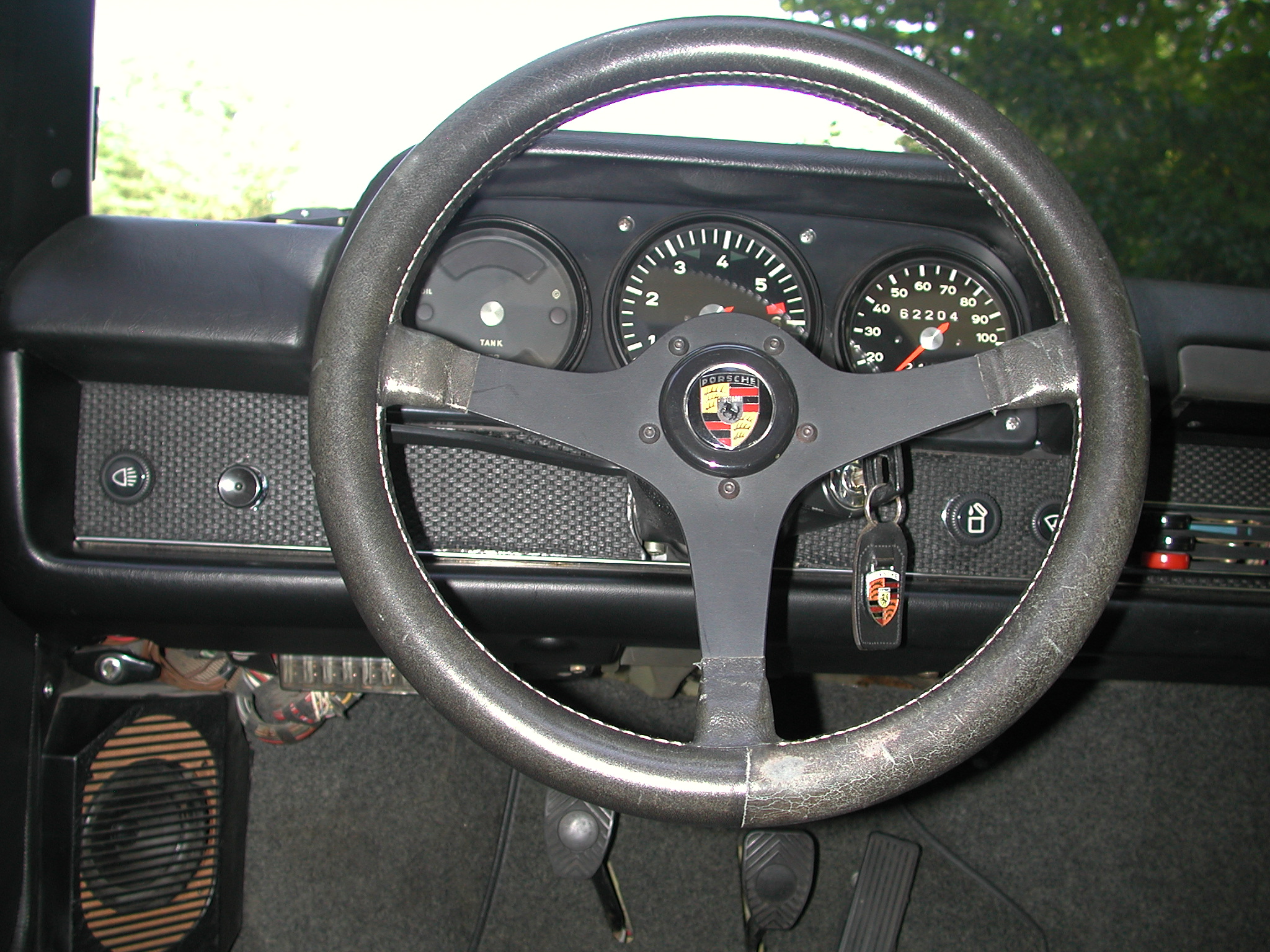

1970 Neun vierzehn   dashboard fascia   Mar 9 2012, 09:45 PM
1970 Neun vierzehn   and....   Mar 9 2012, 09:46 PM

Gustl   obviously the steering wheel is not factory origin...   Mar 9 2012, 11:40 PM
1970 Neun vierzehn   obviously the steering wheel is not factory origi...   Mar 10 2012, 12:09 AM
