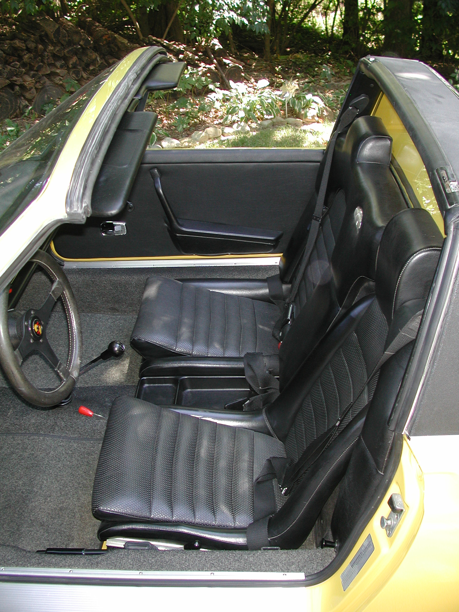

seats

1970 Neun vierzehn   seats   Mar 9 2012, 09:47 PM
Jasfsmith   seats Seat belt safety manufacture labels missi...   Mar 15 2012, 11:33 AM
1970 Neun vierzehn   seats Seat belt safety manufacture labels miss...   Mar 15 2012, 08:14 PM

Gustl   obviously the steering wheel is not factory origin...   Mar 9 2012, 11:40 PM
1970 Neun vierzehn   obviously the steering wheel is not factory origi...   Mar 10 2012, 12:09 AM
