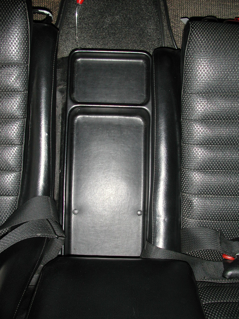

1970 Neun vierzehn   center tray.....   Mar 9 2012, 09:48 PM
