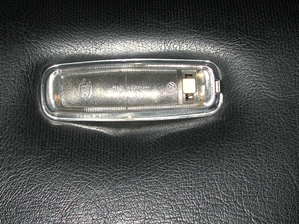

1970 Neun vierzehn   interior light   Mar 9 2012, 09:50 PM
