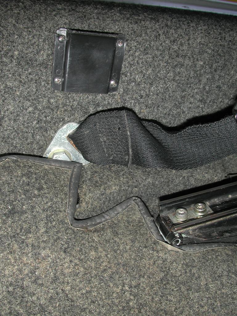

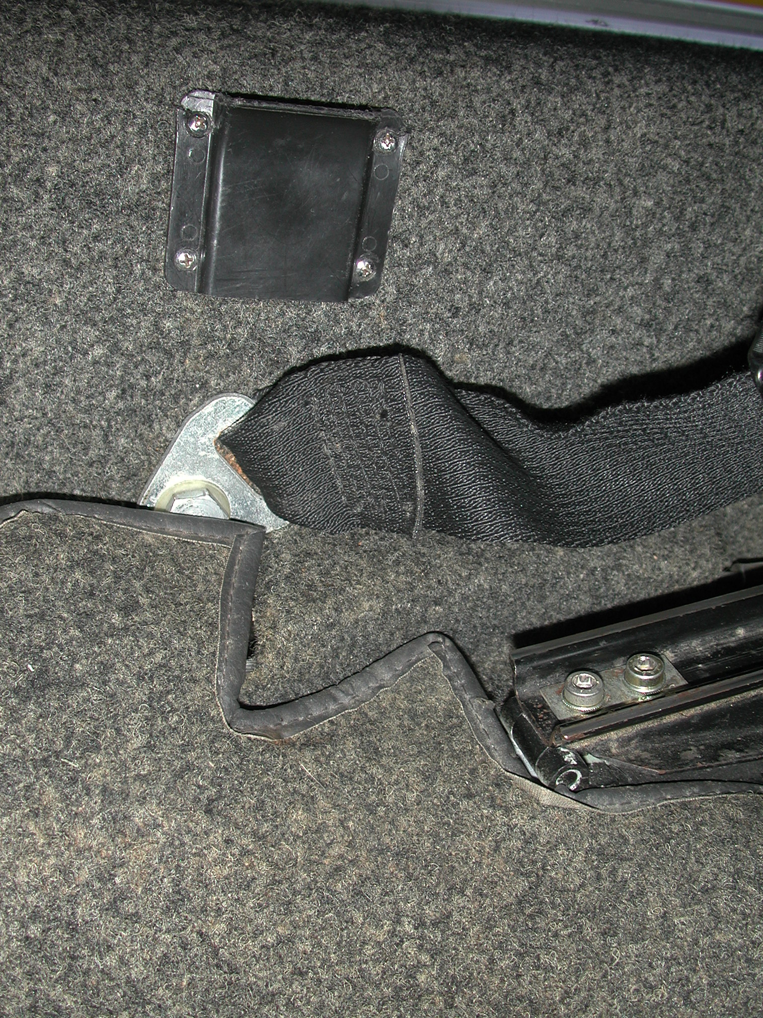

recepticle for the drivers' side (only) seatbelt

1970 Neun vierzehn   recepticle for the drivers' side (only) seatbe...   Mar 9 2012, 09:51 PM
