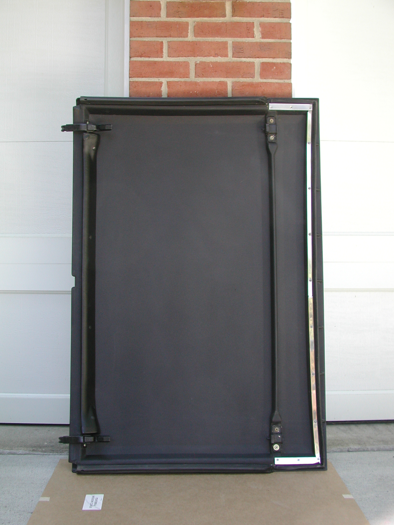

early top, w/o headliner
1970 Neun vierzehn   Original, or not?, a '70/4 inspection   Mar 3 2012, 10:53 PM

1970 Neun vierzehn   early top, w/o headliner   Mar 9 2012, 09:54 PM
Gustl   obviously the steering wheel is not factory origin...   Mar 9 2012, 11:40 PM
