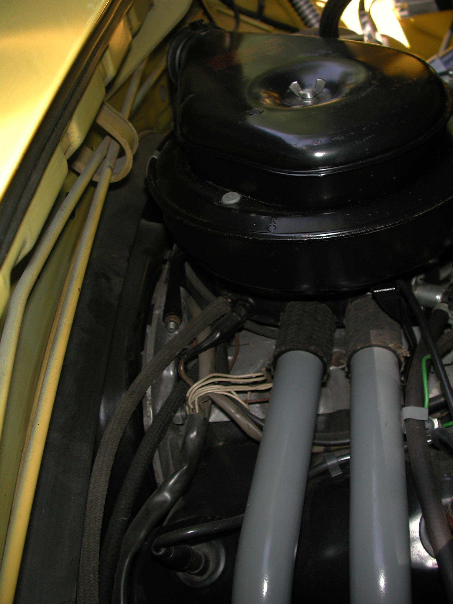

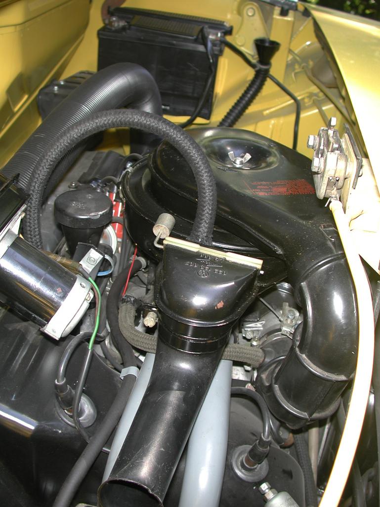

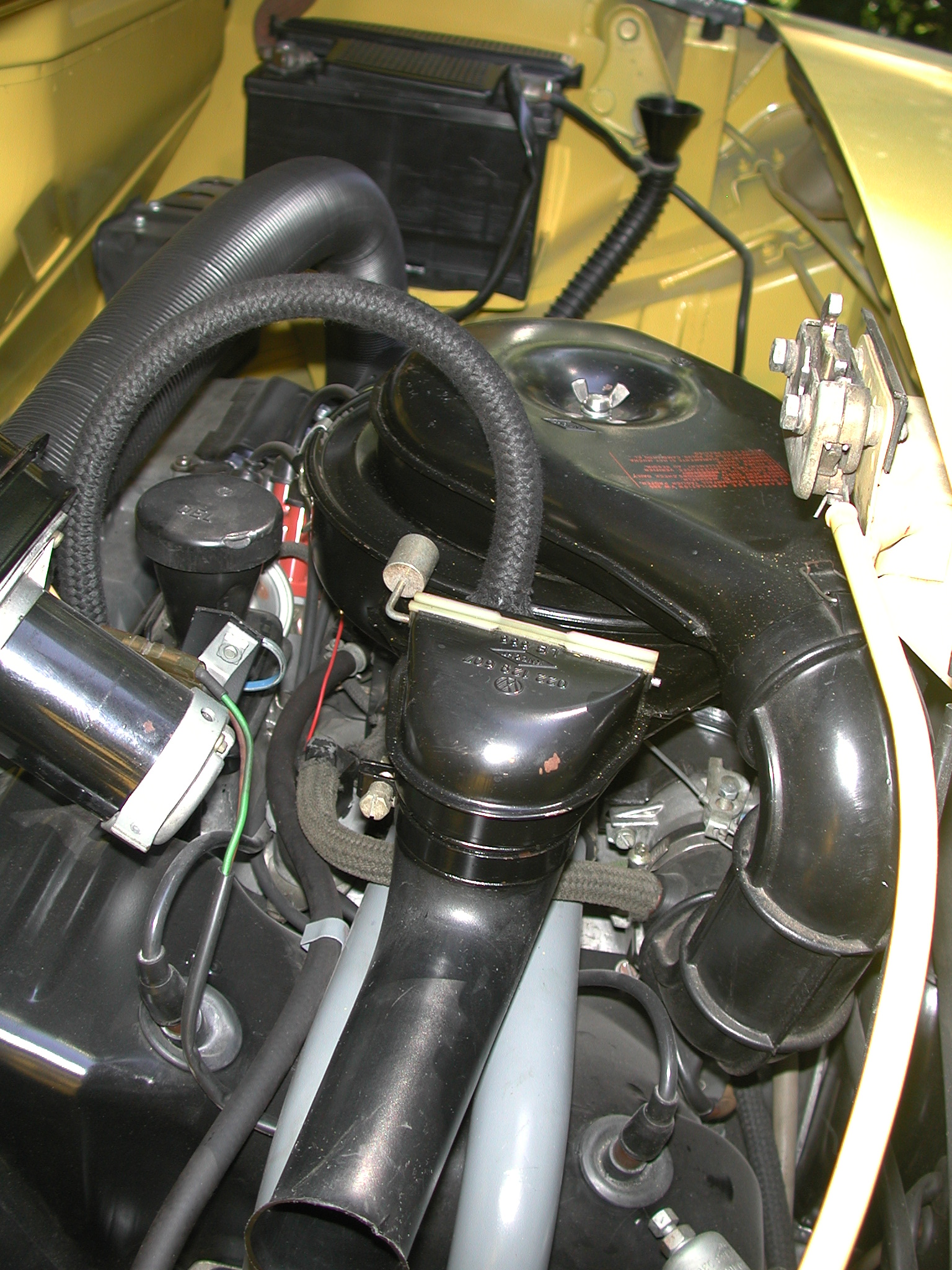

I suppose some photos of the engine compartment are in order to finish this thread. Getting really good pics within the confines of the engine bay is always a challenge. Remember, this is a 1970/4.
Attached thumbnail(s) |

Jasfsmith Missing rubber band to hold the battery cover down... Mar 15 2012, 11:27 AM
1970 Neun vierzehn
Missing rubber band to hold the battery cover dow... Mar 15 2012, 07:58 PM
Jasfsmith
Missing rubber band to hold the battery cover do... Mar 16 2012, 07:28 AM
1970 Neun vierzehn
AA has the rubber band for the early battery co... Mar 16 2012, 05:48 PM![]() ![]() |
