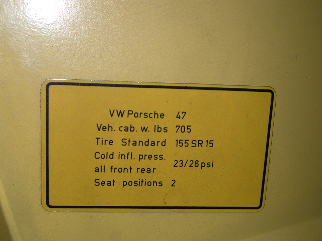

1970 Neun vierzehn   since we are at the rear, let's look in the tr...   Mar 4 2012, 12:50 PM
Jeff Bowlsby   since we are at the rear, let's look in the t...   Mar 4 2012, 06:19 PM
1970 Neun vierzehn   since we are at the rear, let's look in the ...   Mar 4 2012, 08:21 PM
Gustl   the rubber caps at the domes are missing ...   Mar 4 2012, 12:52 PM
1970 Neun vierzehn   the rubber caps at the domes are missing ... Th...   Mar 4 2012, 01:00 PM
6freak   the rubber caps at the domes are missing ... T...   Mar 4 2012, 01:11 PM
sixerdon   the rubber caps at the domes are missing ... T...   Mar 4 2012, 04:26 PM
1970 Neun vierzehn   without the carpet (w/ stain that I can't get ...   Mar 4 2012, 12:55 PM
SirAndy   without the carpet (w/ stain that I can't get...   Mar 4 2012, 04:16 PM
1970 Neun vierzehn   [quote name='1970 Neun vierzehn' post='1638942' d...   Mar 4 2012, 07:39 PM
Pat Garvey   [quote name='1970 Neun vierzehn' post='1638942' ...   Mar 5 2012, 05:52 PM
SirAndy   [quote name='1970 Neun vierzehn' post='1638942' d...   Mar 5 2012, 09:45 PM

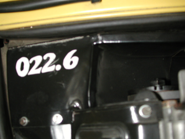

1970 Neun vierzehn   ID #s in trunk   Mar 4 2012, 01:56 PM

Gustl   it the VIN tag (the bigger one) original or repro?...   Mar 4 2012, 04:19 PM
1970 Neun vierzehn   it the VIN tag (the bigger one) original or repro...   Mar 4 2012, 07:43 PM
sixerdon   Confirming Paul's comments...... Rear trunk c...   Mar 5 2012, 05:12 PM

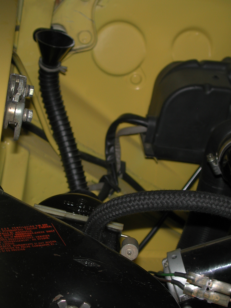

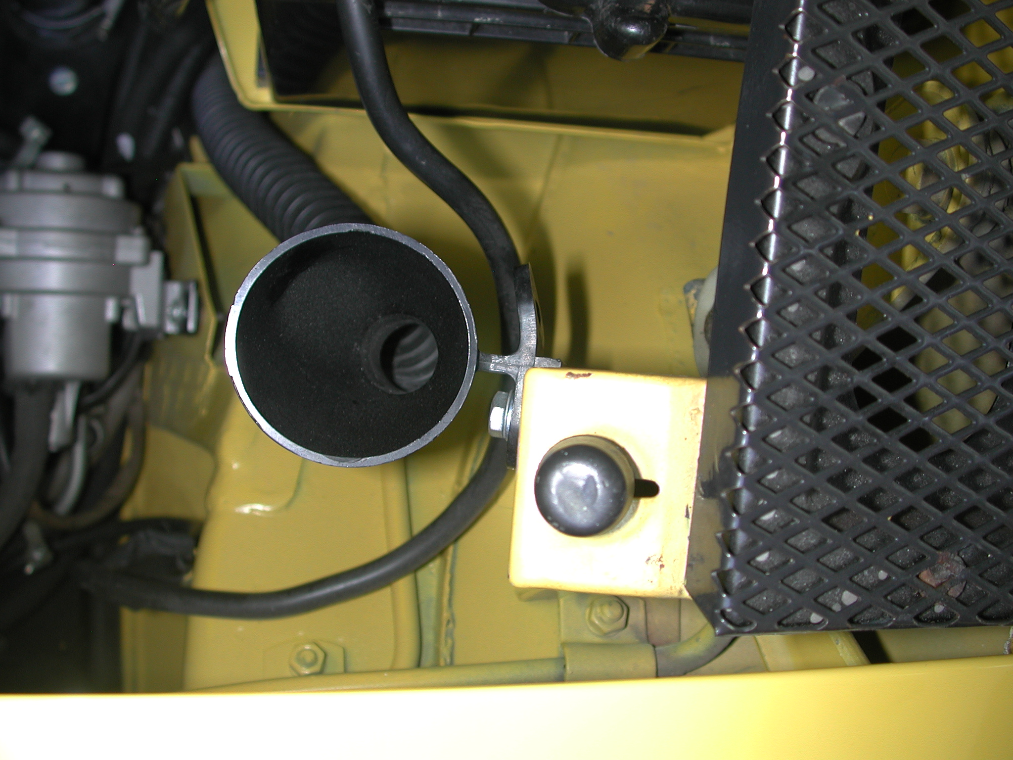

1970 Neun vierzehn   I suppose some photos of the engine compartment ar...   Mar 14 2012, 07:28 PM
1970 Neun vierzehn   more....   Mar 14 2012, 07:30 PM
1970 Neun vierzehn   details   Mar 14 2012, 07:31 PM
1970 Neun vierzehn   details   Mar 14 2012, 07:33 PM
1970 Neun vierzehn   These last two pics show the engine cover removed ...   Mar 14 2012, 07:38 PM

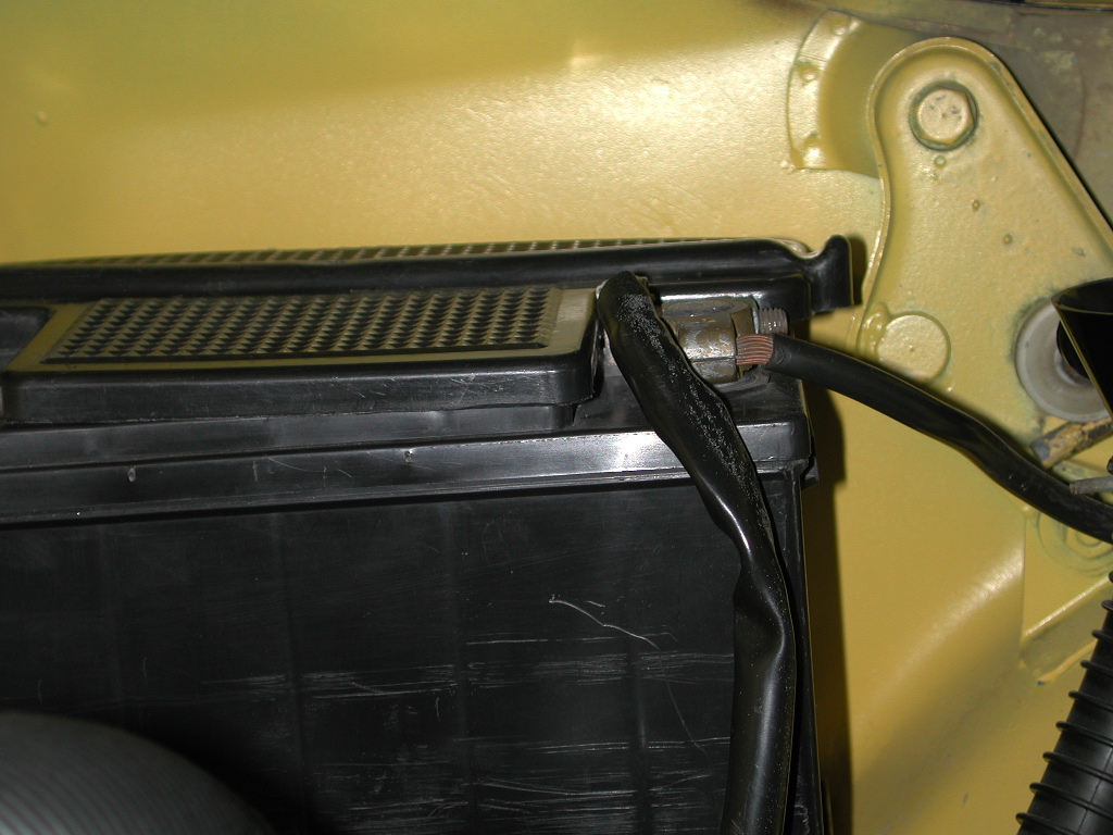

Jasfsmith   Missing rubber band to hold the battery cover down...   Mar 15 2012, 11:27 AM
1970 Neun vierzehn   Missing rubber band to hold the battery cover dow...   Mar 15 2012, 07:58 PM
Jasfsmith   Missing rubber band to hold the battery cover do...   Mar 16 2012, 07:28 AM
1970 Neun vierzehn   AA has the rubber band for the early battery co...   Mar 16 2012, 05:48 PM
