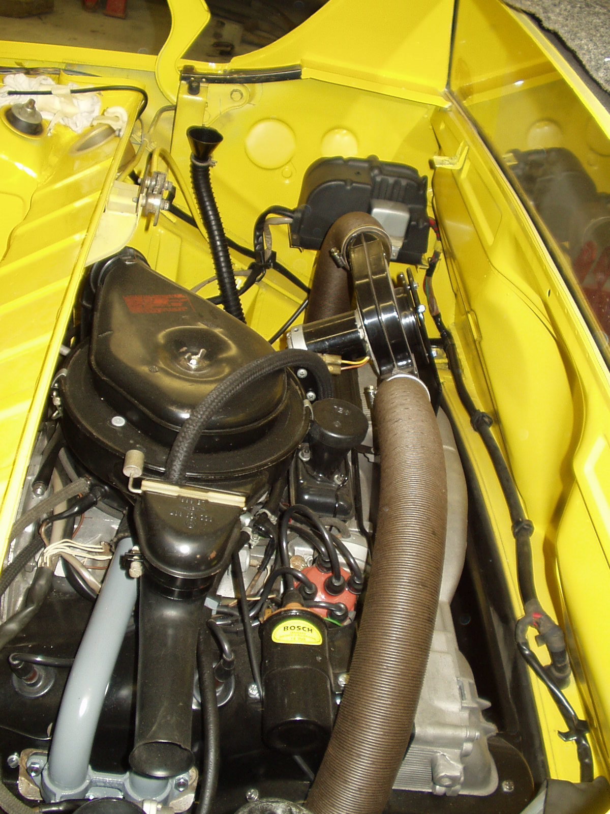

These last two pics show the engine cover removed and incorrect heater blower hose. The correct hose was installed subsequent to when these photos were taken.
Also of note, the oil bath orientation was corrected to what was illustrated previously.

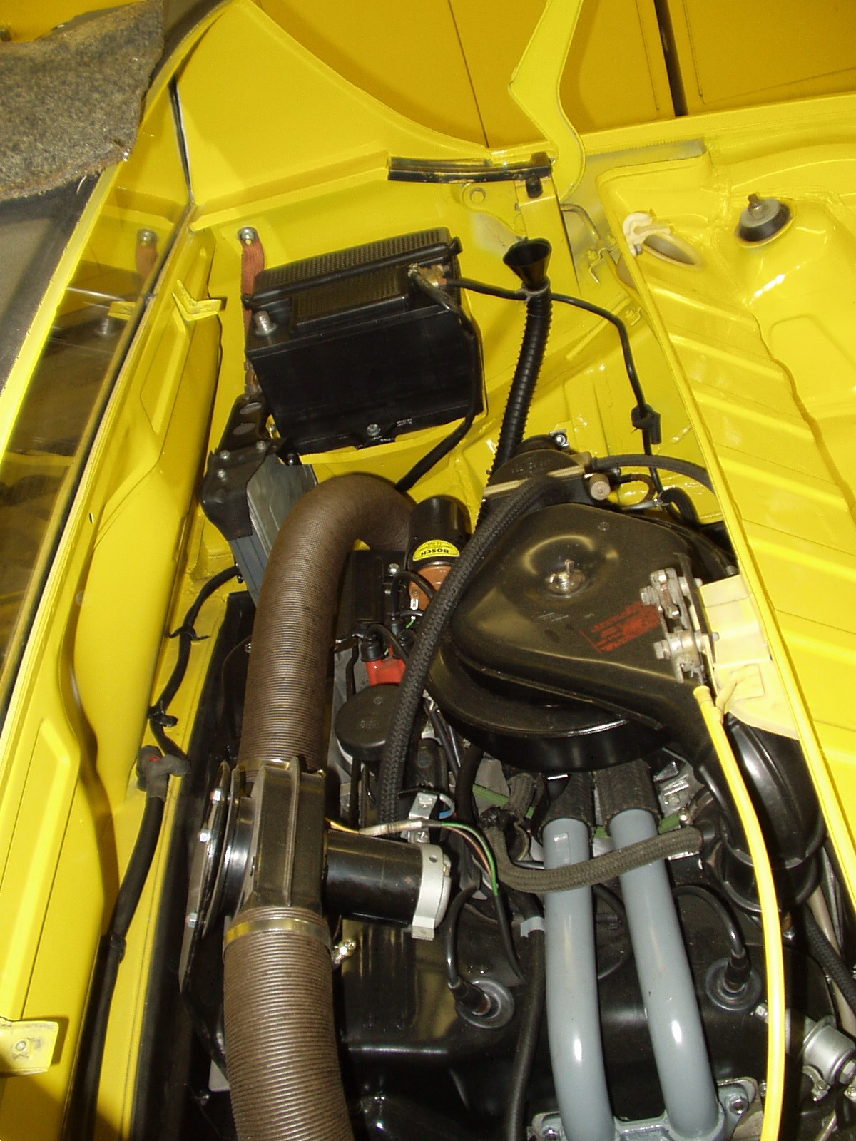

1970 Neun vierzehn   I suppose some photos of the engine compartment ar...   Mar 14 2012, 07:28 PM
1970 Neun vierzehn   more....   Mar 14 2012, 07:30 PM
1970 Neun vierzehn   details   Mar 14 2012, 07:31 PM
1970 Neun vierzehn   details   Mar 14 2012, 07:33 PM
1970 Neun vierzehn   These last two pics show the engine cover removed ...   Mar 14 2012, 07:38 PM
Jasfsmith   Missing rubber band to hold the battery cover down...   Mar 15 2012, 11:27 AM
1970 Neun vierzehn   Missing rubber band to hold the battery cover dow...   Mar 15 2012, 07:58 PM
Jasfsmith   Missing rubber band to hold the battery cover do...   Mar 16 2012, 07:28 AM
1970 Neun vierzehn   AA has the rubber band for the early battery co...   Mar 16 2012, 05:48 PM
