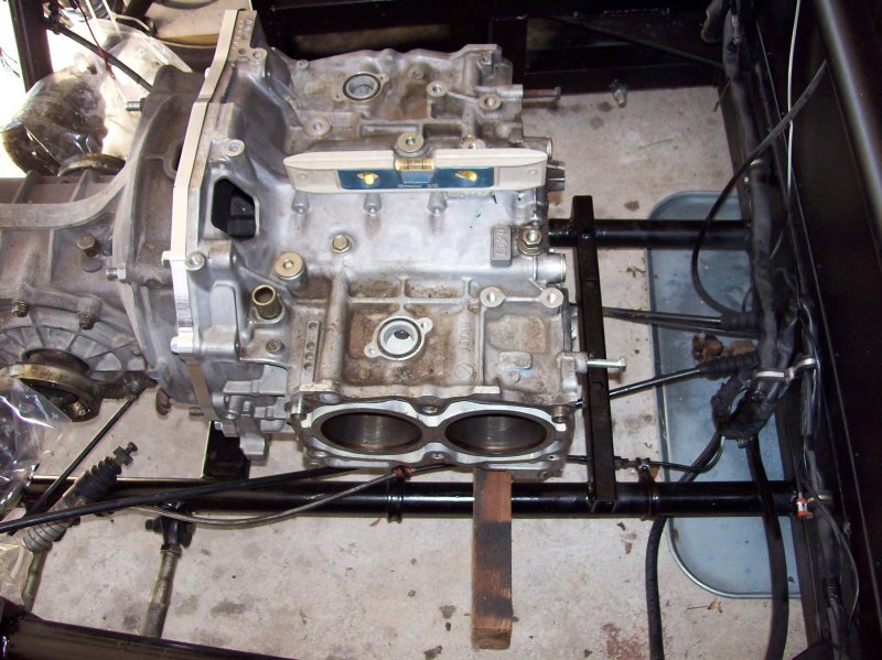

Here's a picture of test fitting a Subaru WRX Turbo in my kit car.
