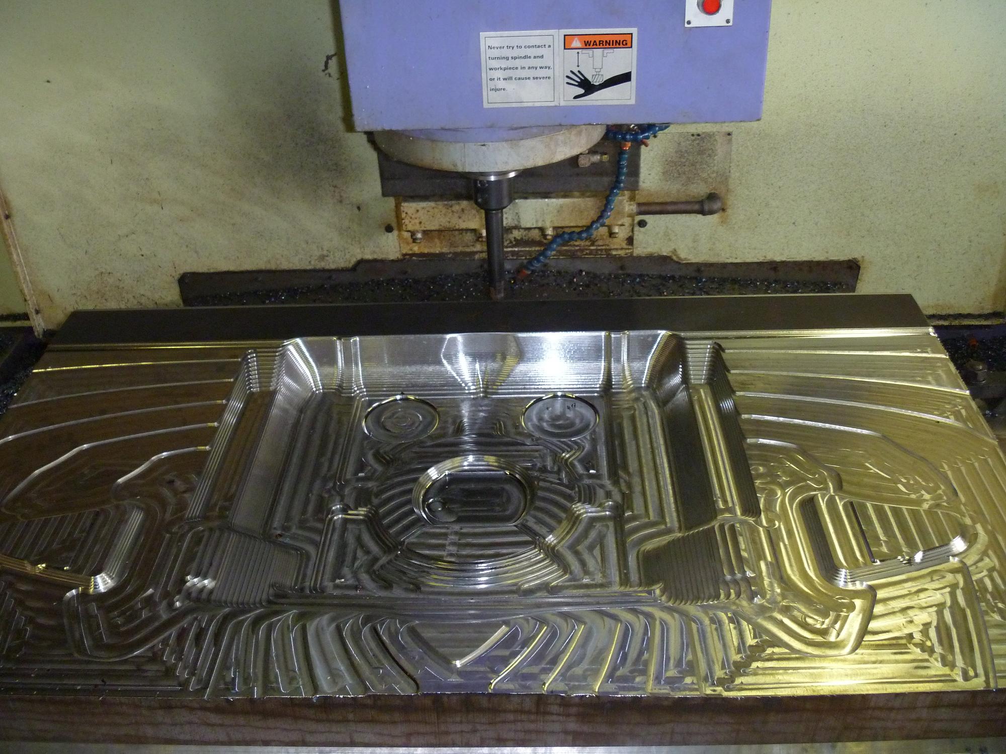

After a long hiatus, I have gotten back to work on the female side of the front trunk pan.
The male side has been all polished, which took two weeks. so now I have to machine the female side and a drawpad, and then bingo bango, a new panel!
Here is a pic of the first rough cut!

a914622   I ran the 1.5 dia at 3000rpm .06 deep at 350 ipm. ...   Nov 18 2011, 11:45 PM

peteyd   After a long hiatus, I have gotten back to work on...   Mar 16 2012, 08:13 AM
