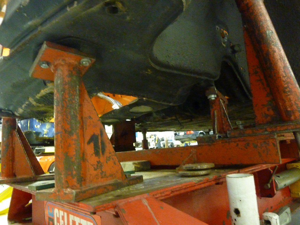

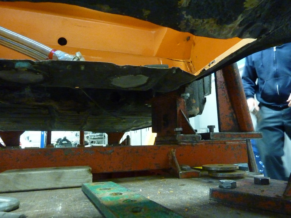

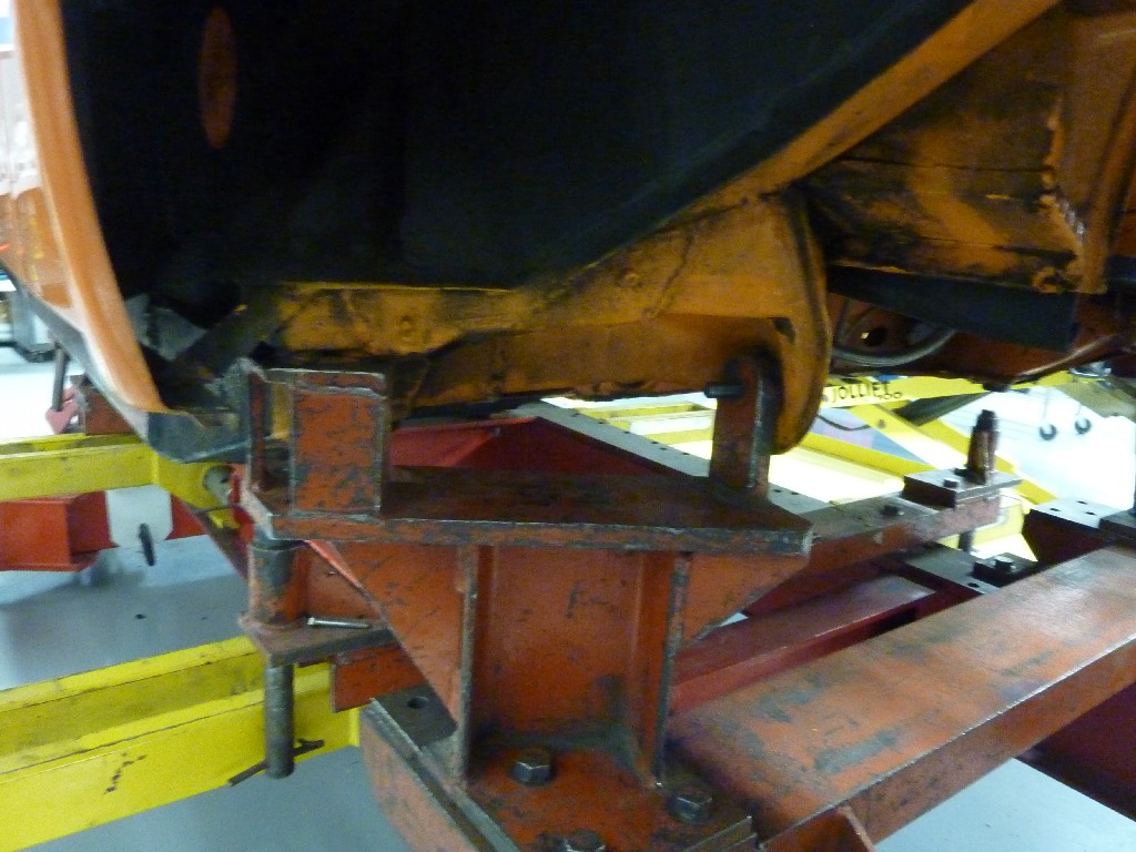

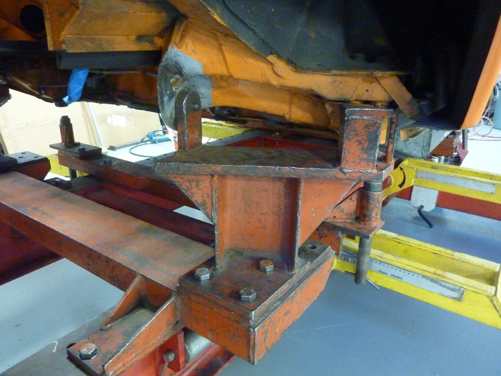

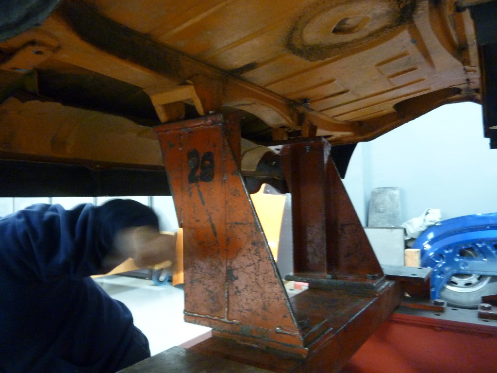

siverson   Some progress was made this week. First, the Cele...   Mar 16 2012, 02:22 PM
siverson   And some shots from the bottom if you're curio...   Mar 16 2012, 02:23 PM
