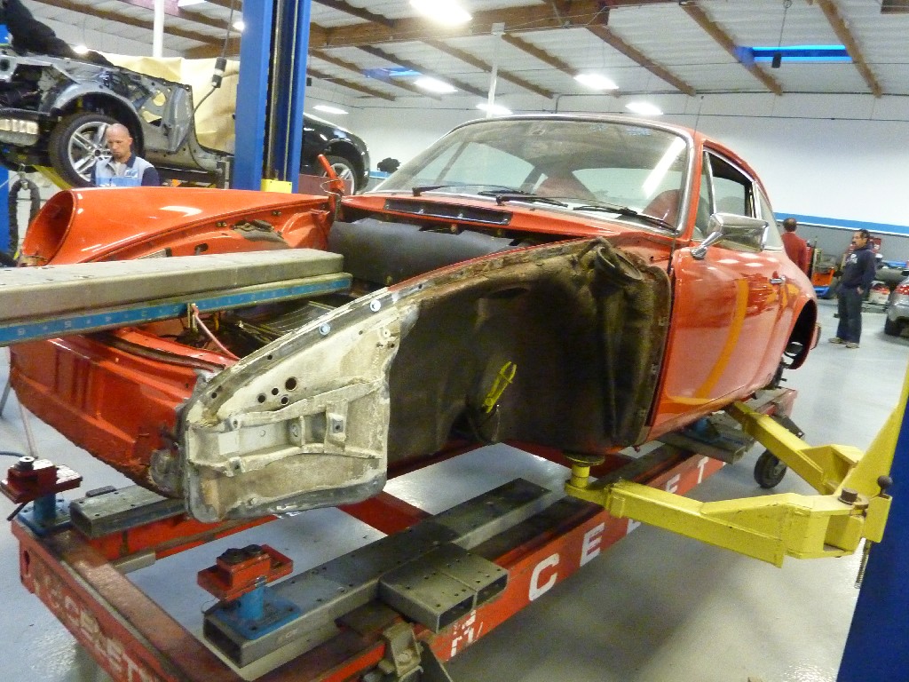

siverson   Some progress was made this week. First, the Cele...   Mar 16 2012, 02:22 PM

siverson   And these photos just in from European Auto Body.....   Mar 22 2012, 05:06 PM

1970 Neun vierzehn   Really nice to see good celette pics. It appears t...   Mar 24 2012, 09:01 PM
