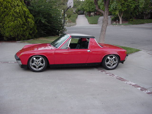

Hey Mueller...
here is what it looks like on the ground...

Duffster   Hey Mueller... here is what it looks like on the g...   May 18 2004, 10:08 PM

retrotech   Duffester, Thanks for the picture. Those are the ...   May 18 2004, 10:56 PM

Duffster   Hey retrotech & Dr. Evil... the magic tire sizes ...   May 19 2004, 11:49 AM
