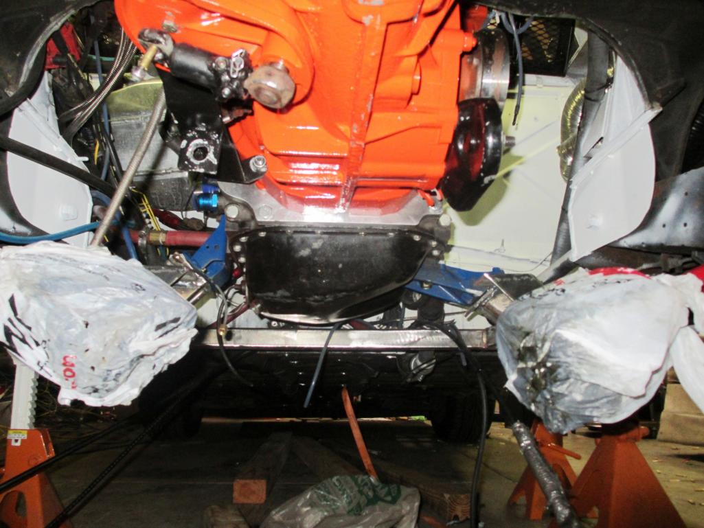

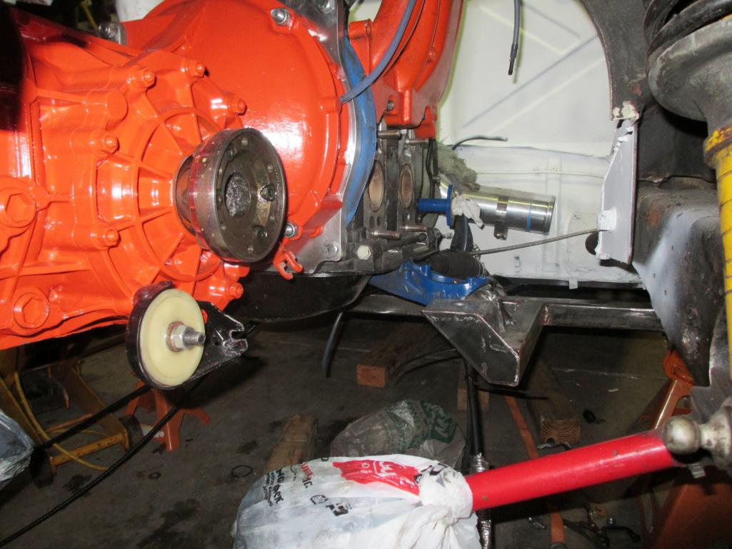

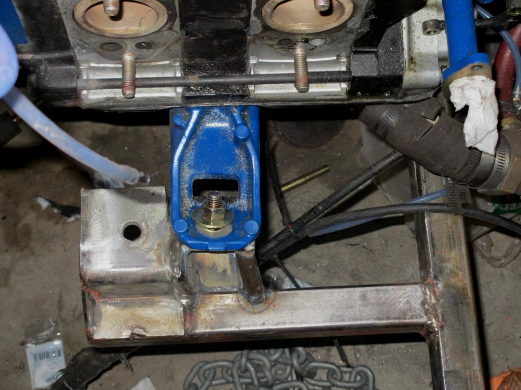

Got the engine and tranny mocked up. I use aircraft stripper on the bar. Found some 1/4" stock and 5/8" DOM to fab the mounts. The original mounting point on the passenger side had to be trimmed to fit around the new one. Got it all welded up and it fits both engines. (IMG:style_emoticons/default/piratenanner.gif)
From the rear you can see how asymetrical the new mounts are. I think in the Rx7 this is done on the passenger side for turbo clearance.
Anyone can fab up a cross bar since the transmission locates the assembly. I hope this inspires some new unusual conversions.
