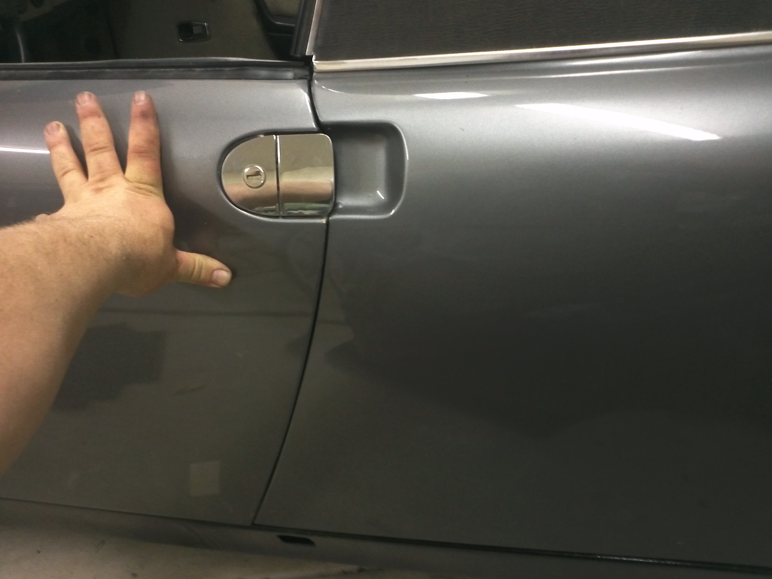

A few years ago I got a new welder, I welded everthing in site... Needless to say I never understood shrinkage.
I installed an Engman kit and not only did I rosette weld the kit in, I fully stiched the whole thing. The end result, a stiff chassis - but a bent tub.
My door gaps are totally fuquered. My passenger rear fender was replaced and they must have welded the front, then the back and I have a weird bubble in my fender well. So not everthing is the same.. My passenger side gap has been messed up since I got the car, huge gap at the back of the door.
Here's my measurements, not to be reconciled with the factor charts too much, I am sure I am measuring from different dimensions than that. Anyways my measurements are from the same spots side to side
Targa opening D 62.7, P 63.5 CM
Latch to hinge D 110.5, P 110.5 CM
Diag mid latch plate to top of targa D 109.4, P 108.4
Front bulkead to targa, D 42.6, P 141.5
My guess is:
the passenger cowl fell in, so did the drivers side
The drivers targa fell in, passenger stayed staticd (lots of welding on the e-brake area)
Pics to follow....

Travis Neff   My plan is to cut through the stiffening kit at th...   Mar 18 2012, 09:23 PM
rick 918-S   My plan is to cut through the stiffening kit at t...   Mar 18 2012, 09:27 PM

Travis Neff   I did my cuts like I showed you before, only cutti...   Mar 19 2012, 07:38 PM
Travis Neff   the car on jackstands, notice that i have the jack...   Mar 19 2012, 09:11 PM
Travis Neff   here's how i was positioning the porta power   Mar 19 2012, 09:12 PM
Travis Neff   here's the gaps after the push, looking a lot ...   Mar 19 2012, 09:14 PM
Travis Neff   tomorrow i will push back the driver's side of...   Mar 19 2012, 09:15 PM

rick 918-S   Good idea with the stands. Be sure to check your t...   Mar 19 2012, 10:26 PM
Travis Neff   a couple days ago i pushed out the drivers front c...   Mar 21 2012, 09:31 PM
Travis Neff   and a before pic - just for comparison. the drive...   Mar 21 2012, 09:32 PM
