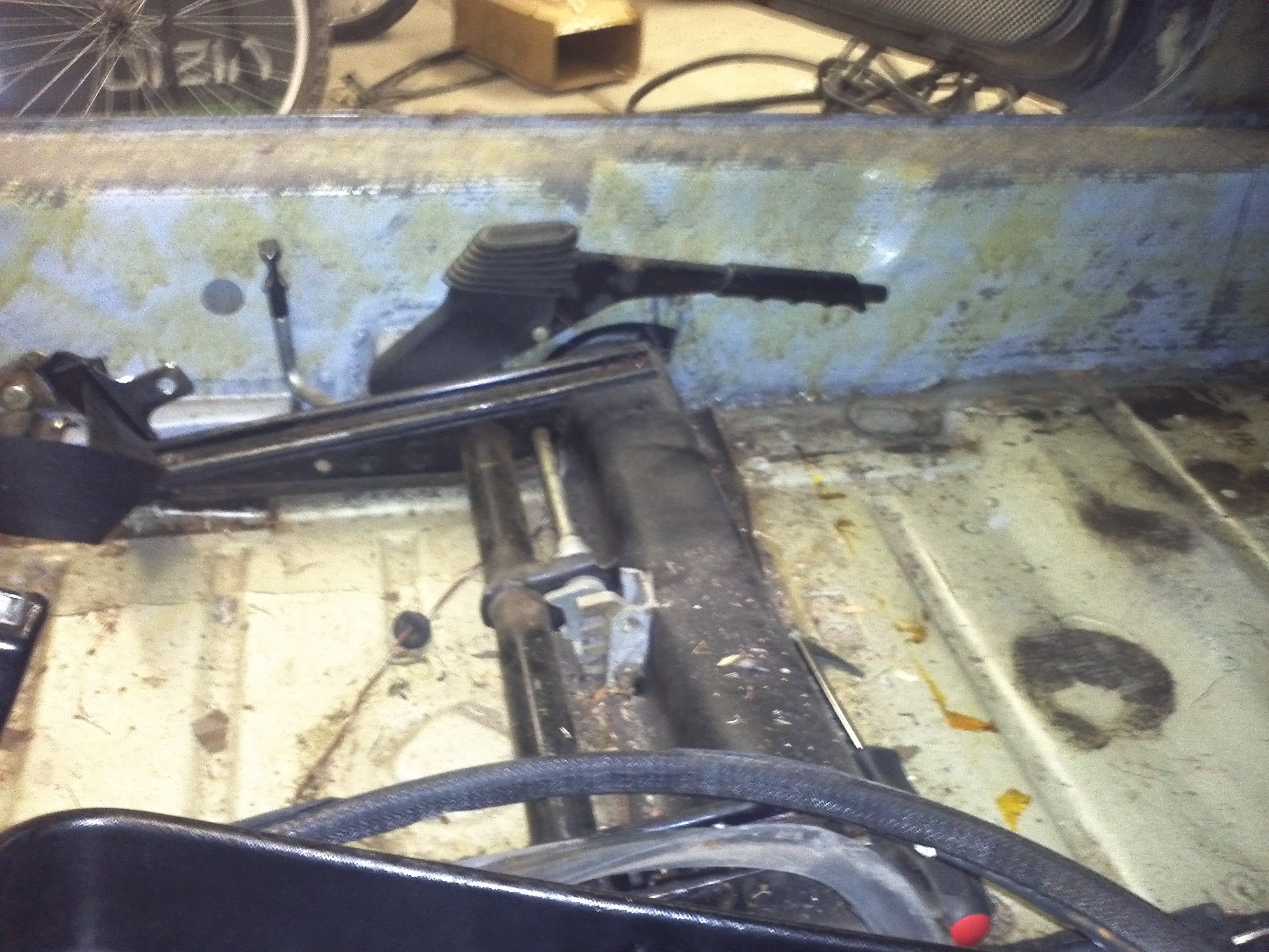

A few years ago I got a new welder, I welded everthing in site... Needless to say I never understood shrinkage.
I installed an Engman kit and not only did I rosette weld the kit in, I fully stiched the whole thing. The end result, a stiff chassis - but a bent tub.
My door gaps are totally fuquered. My passenger rear fender was replaced and they must have welded the front, then the back and I have a weird bubble in my fender well. So not everthing is the same.. My passenger side gap has been messed up since I got the car, huge gap at the back of the door.
Here's my measurements, not to be reconciled with the factor charts too much, I am sure I am measuring from different dimensions than that. Anyways my measurements are from the same spots side to side
Targa opening D 62.7, P 63.5 CM
Latch to hinge D 110.5, P 110.5 CM
Diag mid latch plate to top of targa D 109.4, P 108.4
Front bulkead to targa, D 42.6, P 141.5
My guess is:
the passenger cowl fell in, so did the drivers side
The drivers targa fell in, passenger stayed staticd (lots of welding on the e-brake area)
Pics to follow....

LOL, you're looking right at them. i did my best to make it look like i never installed one - and yes, i would only cut through the stiffener and not through the longs.

QUOTE(Travis Neff @ Mar 18 2012, 10:58 PM) *
Oh, ya ok... Yes just through the stiffener. Be sure to remove the catches. Take your time. Measure twice then measure again. Make yourself a diagram to keep track of your progress. Brace the openings after you get them set before welding. (IMG:style_emoticons/default/welder.gif)
