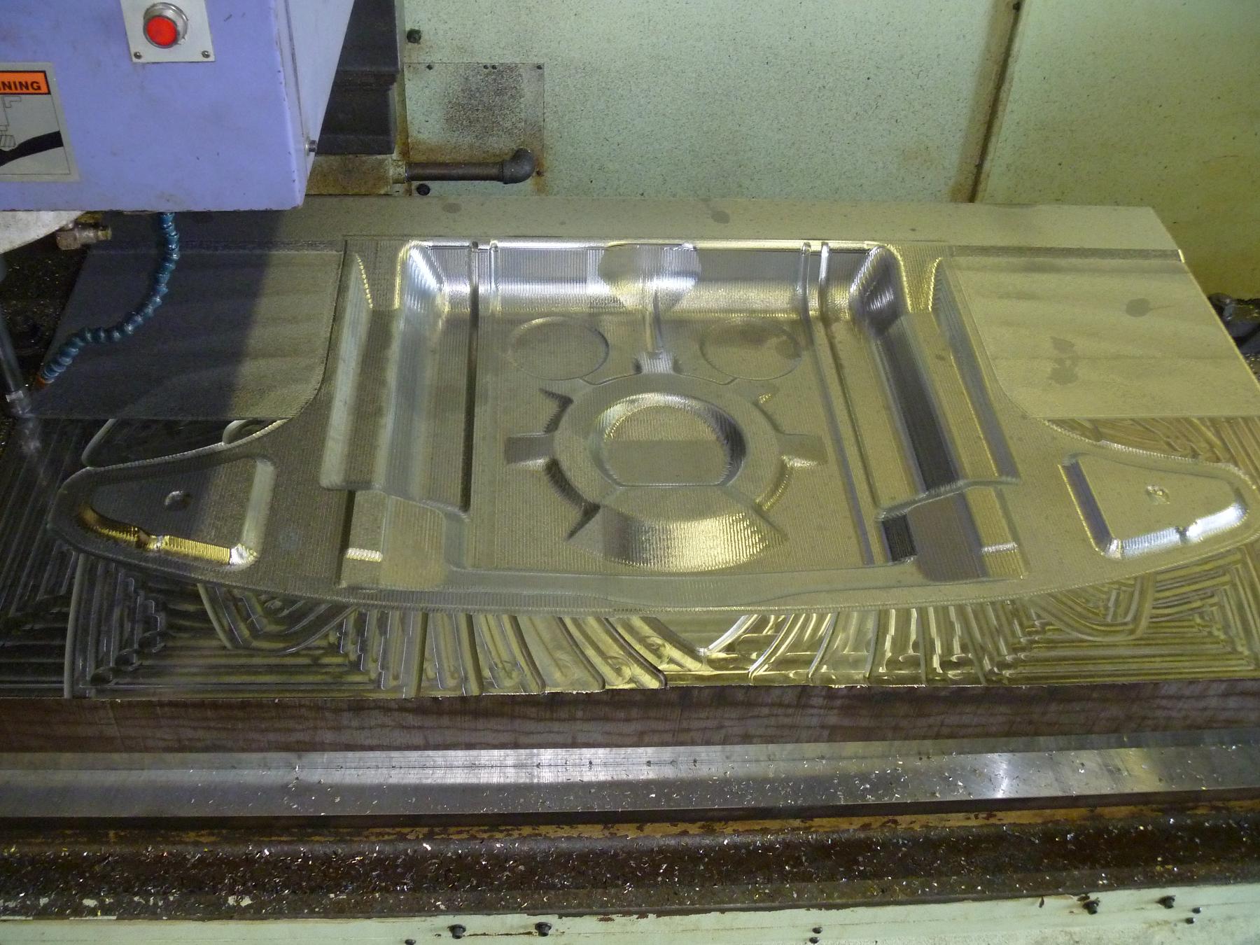

Thanks everyone for all the positive responses. I am glad you guys are enjoying the process.
Over the weekend I got some more milling done. The center has been gone over with a 1.25" ballnose, and will still need to be finished with a .375" ballnose to be able to reach all the tight radiuses.
In the photo it is finishing the flatter areas outside of the pocket, so that I dont have to run over it with another cutter which would just be wasting time.
