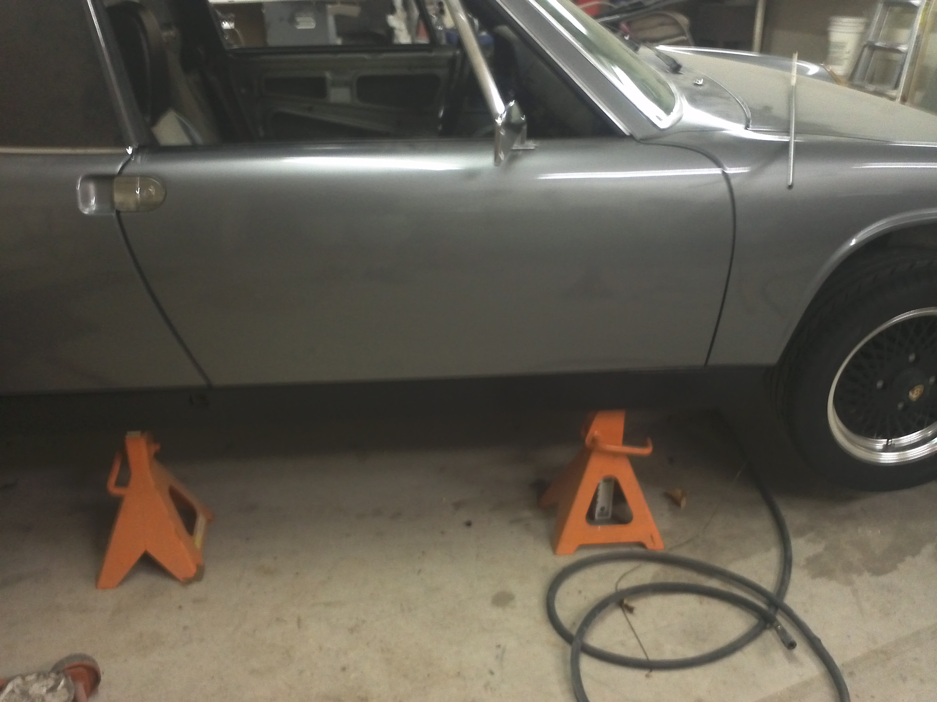

TravisNeff
post Mar 19 2012, 09:11 PM
Posts: 5,082
Joined: 20-March 03
From: Mesa, AZ
Member No.: 447
the car on jackstands, notice that i have the jackstands behind the cowl, this will give me a little more leverage

Travis Neff   the car on jackstands, notice that i have the jack...   Mar 19 2012, 09:11 PM

rick 918-S   Good idea with the stands. Be sure to check your t...   Mar 19 2012, 10:26 PM
