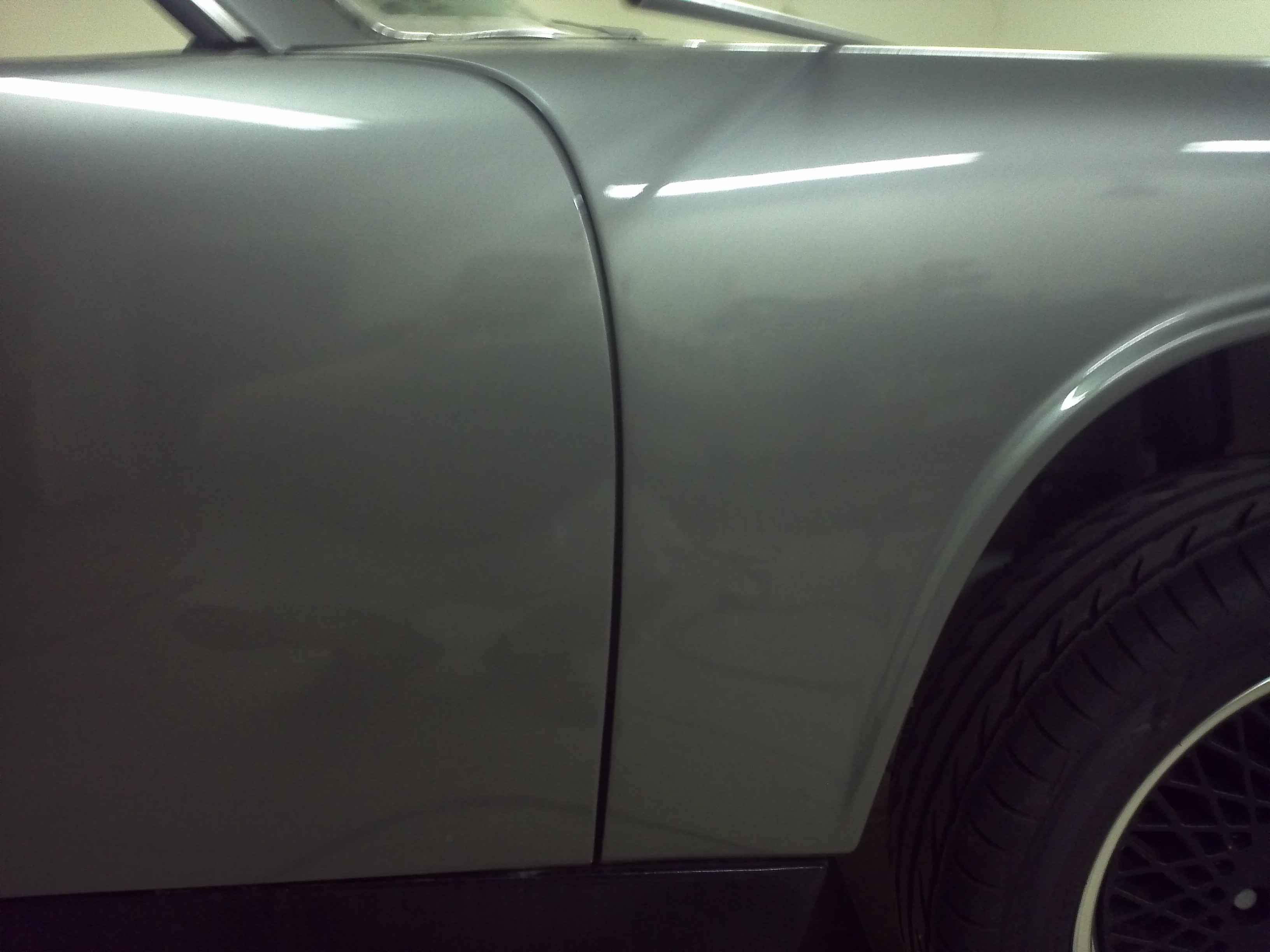

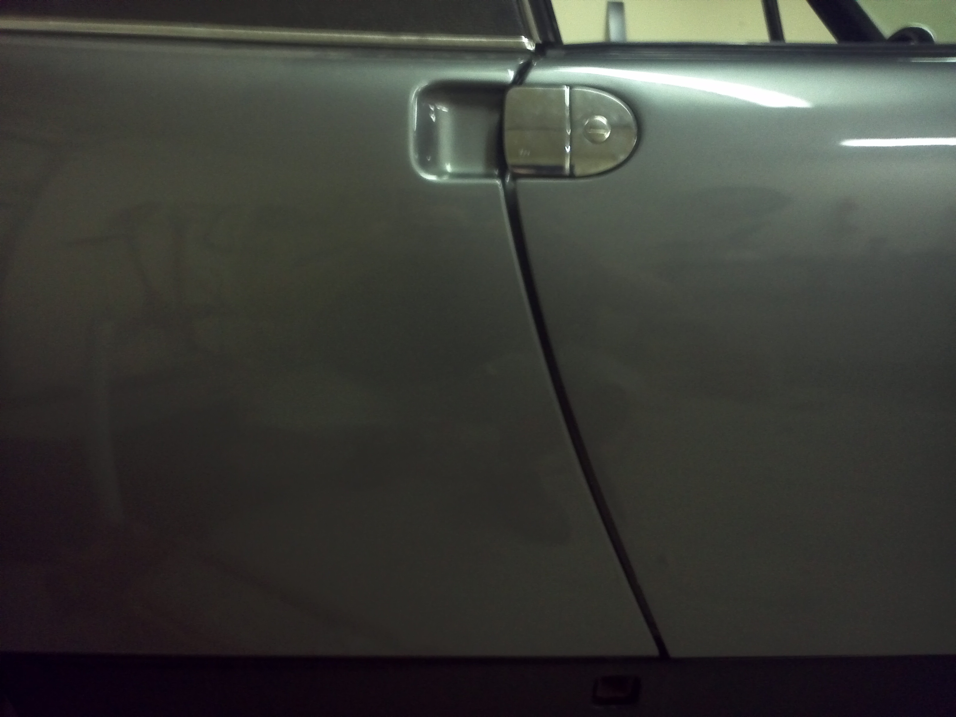

here's the gaps after the push, looking a lot better in the front. the rear has an even gap, but it's big. the passenger side quarter panel was replaced at some point and it was put in a little screwy - more on that later.

Travis Neff   here's the gaps after the push, looking a lot ...   Mar 19 2012, 09:14 PM
