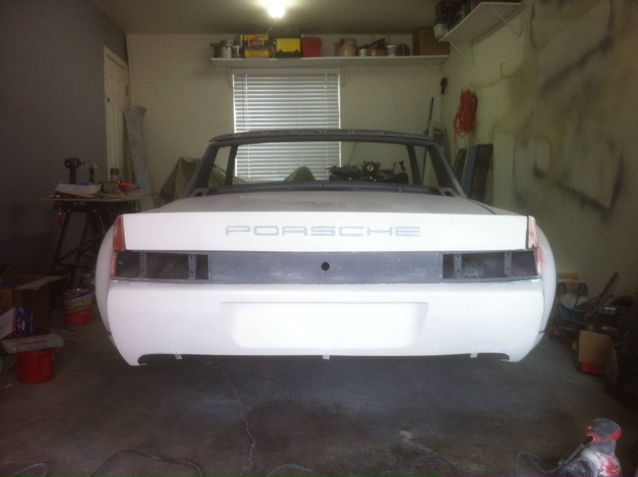

effutuo101   Refitting intakes yesterday. Just a couple of mino...   Mar 13 2012, 10:15 AM
jcambo7   Refitting intakes yesterday. Just a couple of min...   Mar 13 2012, 10:37 AM

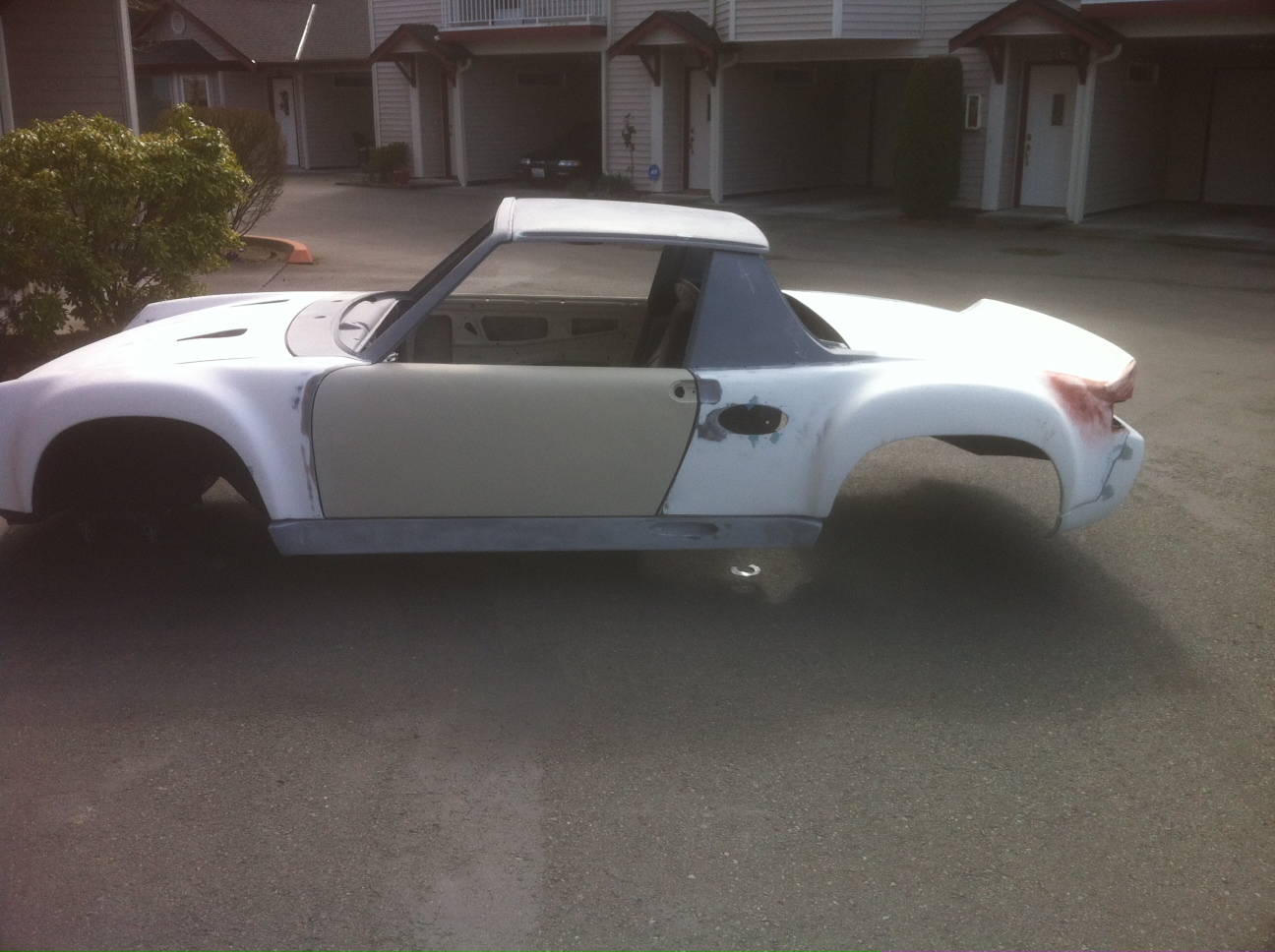

effutuo101   Rear deck fitted, naca ducts finalizes, roof 99.9%...   Mar 14 2012, 09:20 PM

effutuo101   Ok James! didn't get much done today due ...   Mar 18 2012, 07:17 PM
effutuo101   oh, and saw this at work   Mar 18 2012, 07:18 PM
effutuo101   hope to get more done tomorrow.   Mar 18 2012, 07:18 PM
