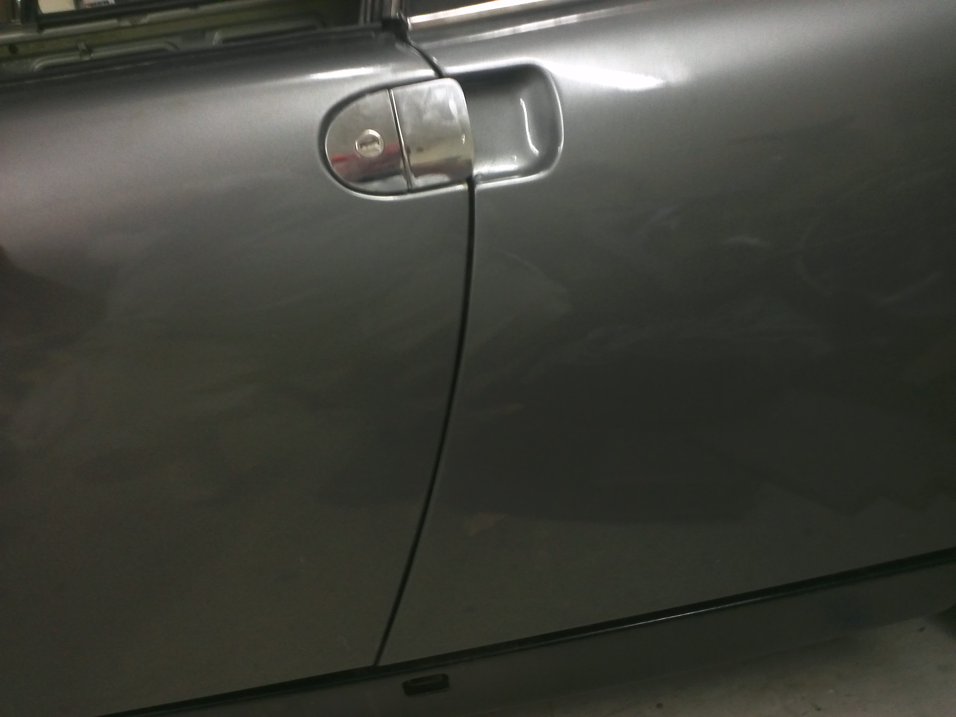

Travis Neff   I did my cuts like I showed you before, only cutti...   Mar 19 2012, 07:38 PM
Travis Neff   the car on jackstands, notice that i have the jack...   Mar 19 2012, 09:11 PM
Travis Neff   here's how i was positioning the porta power   Mar 19 2012, 09:12 PM

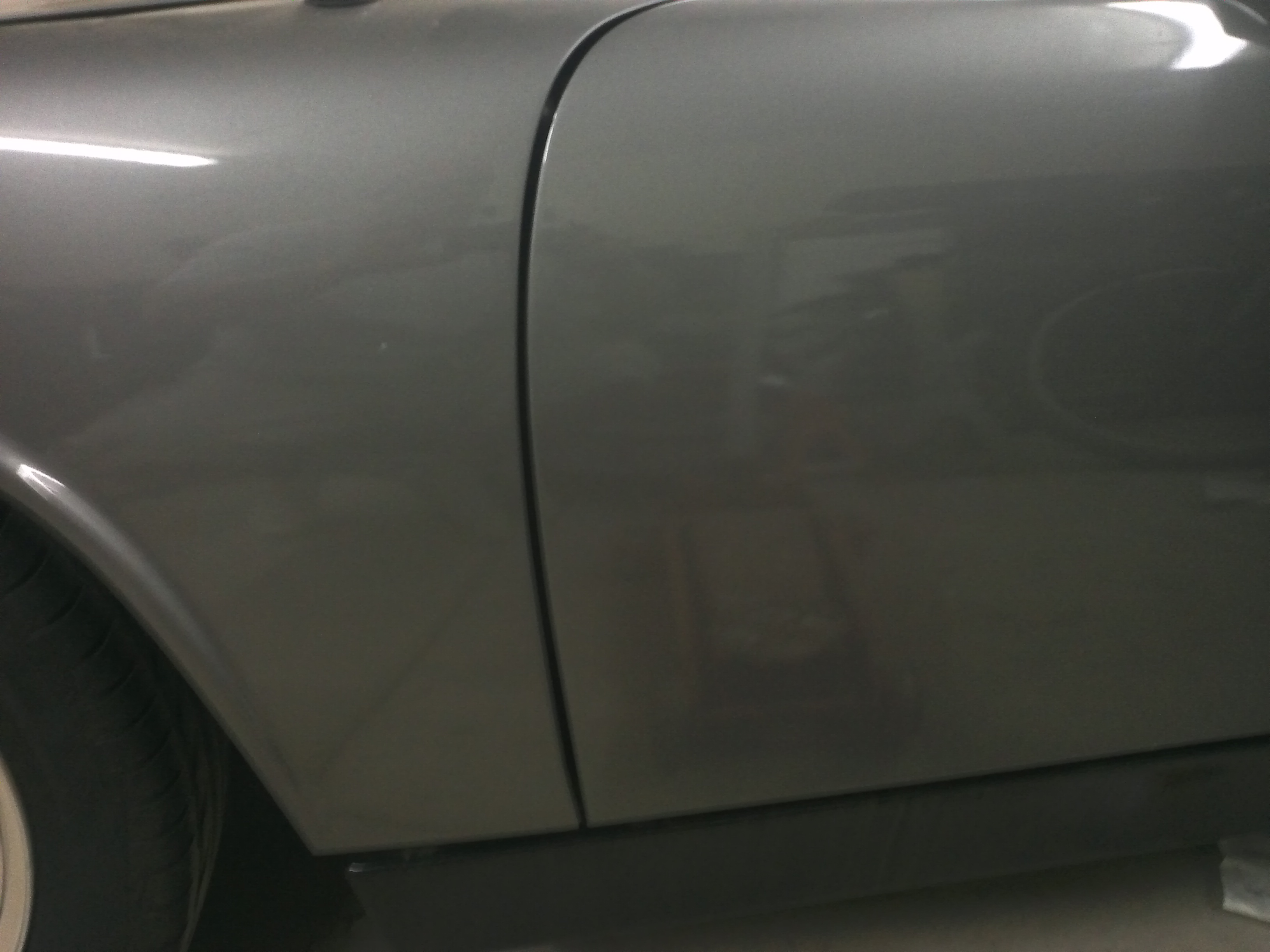

Travis Neff   here's the gaps after the push, looking a lot ...   Mar 19 2012, 09:14 PM
Travis Neff   tomorrow i will push back the driver's side of...   Mar 19 2012, 09:15 PM

rick 918-S   Good idea with the stands. Be sure to check your t...   Mar 19 2012, 10:26 PM
Travis Neff   a couple days ago i pushed out the drivers front c...   Mar 21 2012, 09:31 PM
Travis Neff   and a before pic - just for comparison. the drive...   Mar 21 2012, 09:32 PM
