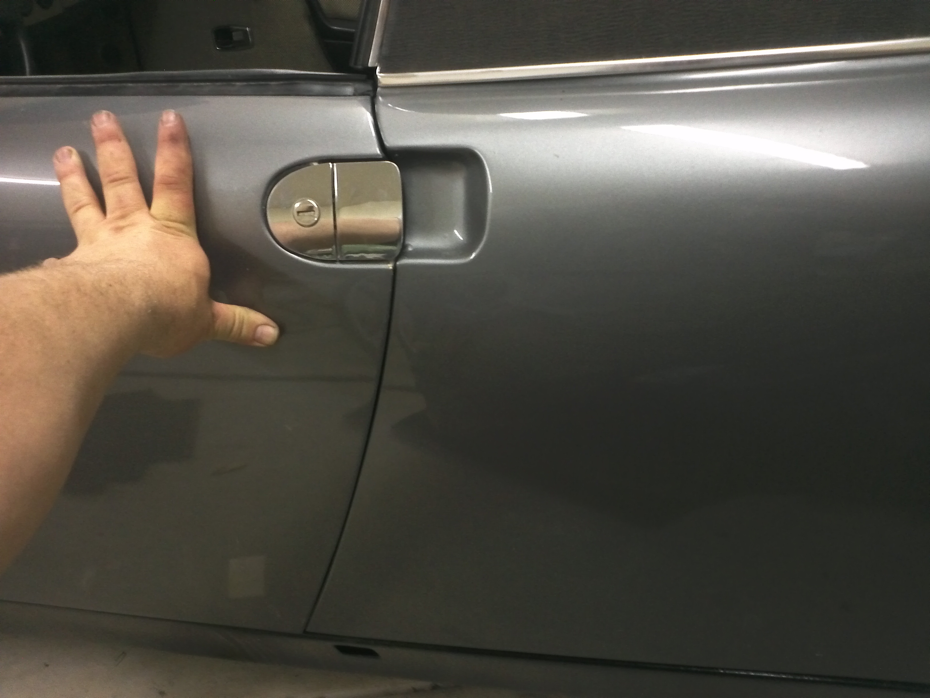

and a before pic - just for comparison. the drivers side is no longer a door slammer!

Travis Neff   a couple days ago i pushed out the drivers front c...   Mar 21 2012, 09:31 PM
Travis Neff   and a before pic - just for comparison. the drive...   Mar 21 2012, 09:32 PM
MoveQik   Looks good Travis. We leave at 1:30 tomorrow so h...   Mar 22 2012, 08:01 AM
Travis Neff   I am trying, but I am not holding my breath   Mar 22 2012, 08:42 AM
rick 918-S   Looking good Travis!   Mar 22 2012, 09:05 AM
