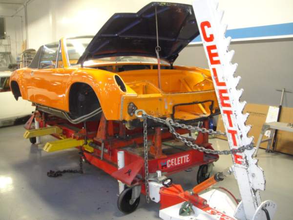

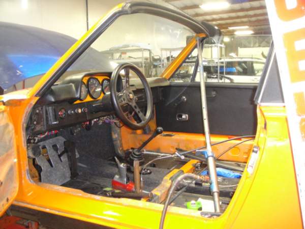

siverson   Some progress was made this week. First, the Cele...   Mar 16 2012, 02:22 PM
siverson   And some shots from the bottom if you're curio...   Mar 16 2012, 02:23 PM
siverson   And another patient that 914 is sharing the room w...   Mar 16 2012, 02:24 PM
siverson   And it's straight again. Lots of strange pulls...   Mar 22 2012, 12:45 PM

1970 Neun vierzehn   Really nice to see good celette pics. It appears t...   Mar 24 2012, 09:01 PM
