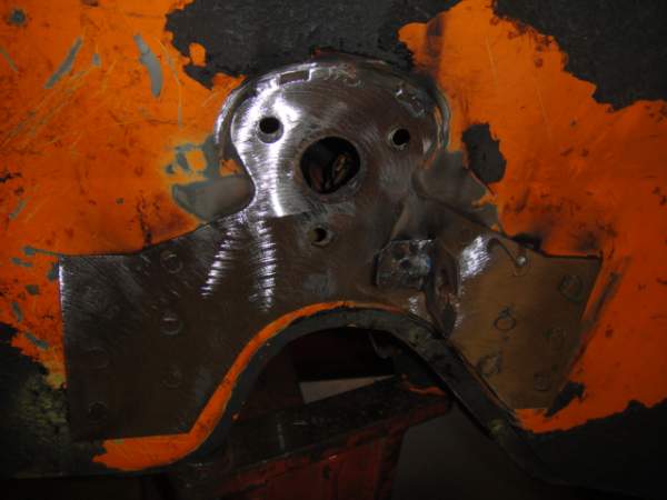

siverson   We'll I'm almost done tearing the car done...   Nov 19 2011, 11:36 PM
siverson   close up BTW - the crack looks sort of old and th...   Nov 19 2011, 11:38 PM
rick 918-S   That crack is very very common. Good to see progre...   Nov 19 2011, 11:44 PM
sean_v8_914   common, most crack there. I could come up with 5-6...   Nov 20 2011, 12:15 AM
siverson   Thanks for the input. Glad to hear it shouldn...   Nov 20 2011, 01:47 PM

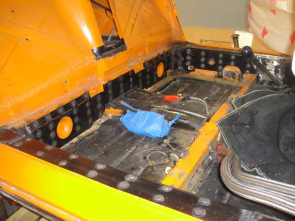

siverson   Finished the tear down this past weekend and got t...   Nov 28 2011, 10:03 PM
siverson   At this point, I was 70% sure I was going to show ...   Nov 28 2011, 10:05 PM
siverson   But it worked out ok. -Steve   Nov 28 2011, 10:06 PM
siverson   Hopefully it will be back together when he's r...   Nov 28 2011, 10:08 PM

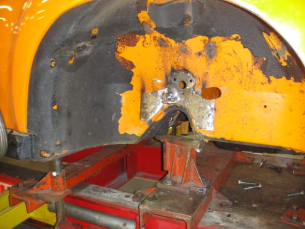

siverson   Some progress was made this week. First, the Cele...   Mar 16 2012, 02:22 PM
siverson   And some shots from the bottom if you're curio...   Mar 16 2012, 02:23 PM
siverson   And another patient that 914 is sharing the room w...   Mar 16 2012, 02:24 PM
siverson   And it's straight again. Lots of strange pulls...   Mar 22 2012, 12:45 PM
