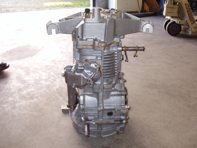

Hi together,
here´s a picture of a 915 we made a revision and converted to 916. It´s for a 914/6 with a 3.2 engine.

post Mar 22 2012, 06:28 PM
Posts: 5,030
Joined: 23-November 05
From: Paramus NJ
Member No.: 5,176
QUOTE(bugat5speed @ Aug 30 2010, 05:15 AM) *
Hi together,
Hello Martin
Please provide an update on the 915 - 914 conversion.
I'm very interested in using a 915 in my 914 3.0 conversion.
Best regards
Rory Gallagher

bugat5speed   Hi together, here´s a picture of a 915 we made a...   Aug 30 2010, 07:15 AM
rgalla9146   Hi together, here´s a picture of a 915 we made ...   Mar 22 2012, 06:28 PM
bugat5speed   @rgalla: sent you a PM in general: kit is running...   Apr 21 2012, 09:55 AM
