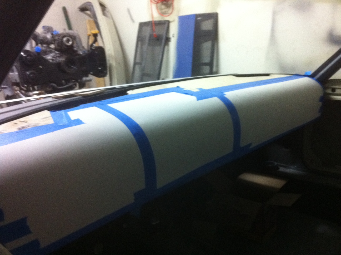

hood pins are Eddie Motorsports. they come in a textured or smooth finish and can be powder coated.
http://www.eddiemotorsports.com/store/cart...015&c=417;;
Playing with some dash idea's late last night...

effutuo101   so, I did it. I cut apart my dash last night and l...   Mar 27 2012, 12:08 PM
PeeGreen 914   Hey Chris, You should make two of those :poke: :...   Mar 27 2012, 04:49 PM
effutuo101   LOL! If you know somebody who can make a mold,...   Mar 27 2012, 06:05 PM

effutuo101   on a con call since 5 am. So, I built and test fit...   Mar 30 2012, 03:00 PM
effutuo101   an now for a picture... pre wax and final prep for...   Mar 30 2012, 03:01 PM
effutuo101   yes, it is a mail box...:) but once I get the glas...   Mar 30 2012, 03:02 PM
